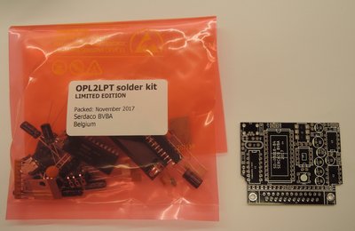

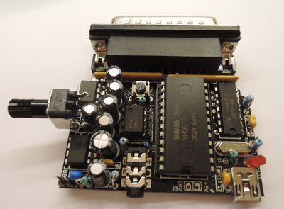

Reply 91 of 566, by dreamblaster
progress... kits available now -- early access for vogons members --
at this moment, solder kits only : 30 euro for component kits + PCB
pm me if interested
    238.39 KiB
    1691 views
    273 KiB
    1691 views
Thanks for your support !
