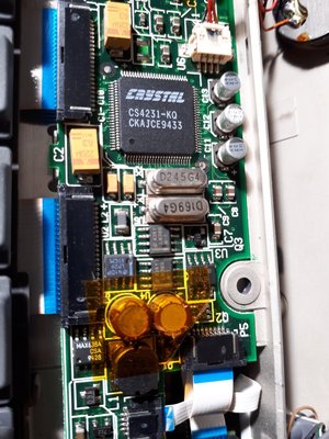

Reply 6 of 8, by rawonam
I had to open the computer to see the sound card, it turned out to have a CS4231-KQ chip, nothing else that I could identify. Not much info on the Internet.
I found some drivers for Noteflex 486 laptop (crysemaud.zip is circulating on the net), it is indeed a CS4231 driver, but the package is missing 12 files, among them all the *.drv, so it can't be used. Notable is that it by inspecting setup.inf one can see that opl3.drv is supposed to be installed and the port is 388h. Doesn't help too much either.
The drivers for CS4232 don't work either: they install correctly, but digital sound plays in a loop or hangs the system, MIDI is played without visible issues, but no sound is heard from anywhere.
I guess to have MIDI sound I'd need to find a PCMCIA, serial or parallel solution.
Reply 7 of 8, by gerwin
The CS4231 codec is well documented and very common: http://www.cebix.net/downloads/bebox/cs4231a.pdf
It is practically identical to the Analog Devices AD1848 codec, as found on an actual Windows Sound System ISA card.
The Windows Sound System ISA card is the only card I know of which has no controller chip paired with such a codec. This means it is pretty bare and hardware incompatible to anything but WSS itself. So the same goes for your laptop.
CS4232 is not comparable at all. since it is a controller and codec together in one chip. The controller handles PnP, Bus interfacing, SB compatibility, MPU and FM interfacing, Joystick and sometimes IDE/CD-ROM interfaces. This is the usual way in which soundcards were designed. Your laptop seems to lack a controller chip and therefore does not have such functionality.
Your best bet are Laptop specific WSS drivers, or maybe the drivers for the original WSS ISA card, since it is the only card comparable to the hardware in your laptop. Except that your laptop is missing the FM/OPL chip, AFAIK.

Reply 8 of 8, by rawonam
gerwin wrote:
The CS4231 codec is well documented and very common: http://www.cebix.net/downloads/bebox/cs4231a.pdf It is practically identica […]
Your best bet are the drivers for the original WSS ISA card, since it is the only card comparable to the hardware in your laptop. Except that your laptop is missing the FM/OPL chip, AFAIK.
Thanks gerwin!
Well, I do have working drivers (WSS), just wanted to make sure that there is no OPL3 chip there. Looks like there isn't.
I found instructions for the laptop that instruct first to install this Crystal Business Audio driver before installing Windows Sound System, so I thought there might be something more than pure WSS there. Apparently there isn't, because I can't see how they differ, digital sound works well without the Crystal Business Audio.
