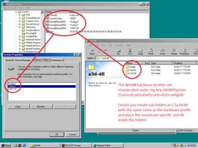

I made a rudimentary script to overwrite a3d.dll in c:\windows\system under Win98 when using hardware profiles with different sound cards.
I created the script because I've experienced blue screen of death if I accidentally use an incorrect a3d.dll for a sound card, and I got tired of copying the file when I switch hardware profiles.
The requirements are Windows Script Host (Windows 98SE Unofficial Service Pack 2.1 installs it), Win98SE (not tested with Win95, Win98FE, or WinME), and more than one hardware profile.
The script does not check if it is running under Win98 and I cannot take responsibility if your OS gets corrupted from using the script.
To use the script create hardware profiles and matching sub-folders under C:\a3d-dll. In those folders copy the proper a3d.dll corresponding with the sound card.
You also have to modify the hardware profile names in the script under the "Select Case" section in the script.
When done, place the script in your startup folder at C:\WINDOWS\Start Menu\Programs\StartUp. Then when you boot up into your hardware profile, the script will automatically copy the proper a3d.dll file to c:\windows\system. You can also double-click the script to verify the proper a3d.dll is copied.
Improvements to the script could be: not overwriting a3d.dll unless necessary, better coding, and easier method of changing the variables for hardware profile names.
