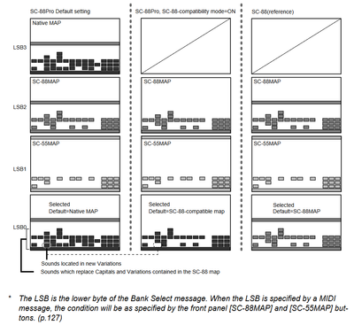

I've looked in the manual and I don't get it. Can someone explain to me, what is the difference between choosing a different map and compatibility mode? Looking at the picture from the manual, I don't see differences between the SC-88Pro default mode SC-88 map, SC-88Pro SC-88 compatibility mode default map and the SC-88 map.
    50.82 KiB
    3154 views
    SC-88pro compatibility mode

They should in theory be the same. There's a lot of duplication and double counting in the way more advanced SC devices consider previous map support.
It'd be much more unlikely that they differ in some ways, because that would require extra waveforms, memory or programming. Chances are it's just multiple roads that lead to Rome. The SC-8850 has even more instances like this.
See here :
derSammler wrote on 2017-11-25, 10:32:
Hold SELECT and press "Instrument <" and "Instrument >" at the same time .... First of all, since most people don't seem to know […]
First of all, since most people don't seem to know that, just pressing "SC-55 Map" or "SC-88 Map" does not change GM patches! It only changes the mapping of the additional instruments in native mode. For GM playback, this is completely irrelevant. The only difference you may hear is due to capital tone fallback, which is affected by this.
To change GM patches and make the SC-88 Pro sound exactly like the SC-55 or SC-88, you must first enter compatibility mode:
Hold SELECT and press ALL; ALL will be blinking indicating compatibility mode
Now you can use the "SC-55 Map" and "SC-88 Map" buttons to make the SC-88 Pro sound like a SC-55 Mk.II or SC-88.
Changing only a map doesn't give you the same sounds as they should be generated according to the rules as it was in the original SC of which map you selected. You can try this by sending MIDI commands and play the same midi file on different modes and here difference. To here it you have to use original SC or RAW recordings (in WAW format) with hight sampling rate that SC can produce to capture all nuances of sound.
