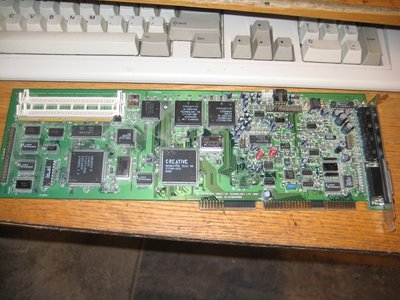

I've had this CT3990 lying around for the longest time in my room. As it had Creative's awful CQM b*stard child instead of a half-decent FM chip, I utterly refused to use it.
Well, today I worked up the courage and scavenged the needed parts off a CT2900 ViBRA 16S, and removed both the CT1978 CQM chip and its associated TDA1387 DAC and coupling/filtering capacitors, and I migrated the missing capacitors, resistors and resonator over to the CT3990, along with the YMF289B and YAC516-E chips. Thank goodness for SRA Fast Chip.
And it worked, first time. Lemmings played in glorious real Yamaha OPL3 sound. 😁 So now I have probably the only CT3990 I've ever seen with genuine OPL3 synthesis instead of the wretched CQM garbage.
Tomorrow I'ma take a hammer to the CT1978 chip and forever banish it to oblivion where it belongs. The CT3990 has a broken SIMM RAM slot (common problem on old AWE32s) so that has to be fixed too.
Here's a picture:
The attachment IMG_0479.JPG is no longer available

Reply 9 of 96, by Eep386
Ask and ye shall receive. 😀

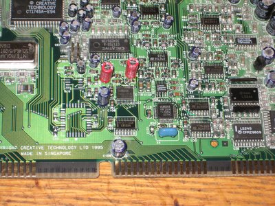

I cleaned up the board after taking this shot, it looks much less fluxy in real life:
The attachment IMG_0480[1].JPG is no longer available
Those with a hot-air station will probably find this much easier going than I did, I had to use my Elenco soldering iron with SRA Fast Chip, which necessitated me cleaning the pins with copper braid to get rid of the alloy mess. Getting the YMF289B in there, with its tiny, fine pins was sure "fun"! 😜 The YAC516-E was much easier thanks to its much wider pin pitch.
Later I'll tweak the onboard op-amps that control filtering and gain, to try to get the best sound possible out of it. Those who manage to make out my slightly blurry pics (bless my Canon SD1000...) might notice that I've changed some of the MC3403 op-amps to TL074s. I'll change the one that buffers and filters the FM to an MC33079 later.

Reply 12 of 96, by Eep386
Well, you also need the 33.88 MHz ceramic resonator, and a bunch of passive capacitors and resistors, and some electrolytic capacitors.
Unfortunately I did not identify the values of the capacitors as I was swapping parts from the donor CT2900 into their respective locations on the CT3900. However, the resistors I did identify however are a 10 ohm resistor, a 3.9K resistor and two 47K resistors. You also need two 1uF capacitors and a 10uF capacitor. There may be more parts too, but those are the ones I can make out.
The way I did the swap, was I sat down and took a good hard look at the CT2900 and the empty pads on the CT3990 and tried to guesstimate where the appropriate parts went. The easiest way to do this, provided you've got the tools to extract the parts without damage, is to simply scrap the needed parts off a lesser sound card with YMF289B. A broken CT2900 or one of the cost-reduced later boards that omit the TEA2025 or TDA1517 makes a decent donor candidate.
For a CT3990, the 10 ohm resistor goes to R30, the 3.9K resistor goes to R50 and the two 47K resistors to R88 and R91.The 1uF caps go to C86 and C116, while the 10uF goes to C105.
Oh yeah, you also have to remove the CT1978 CQM chip at U20 and accompanying TDA1387 DAC from U19.
Maybe once I get more free time, I'll desolder those caps I didn't identify and try to identify them. I want to make public knowledge a method to evict CQM from CT3990s.

Reply 14 of 96, by Eep386
Before I continue, let me just say this: this information is provided as-is, free of charge, with no guarantees of any kind.
OK, now that that's out of the way, let's try reverse engineering the caps I put in there...
For reference, all part references are specifically for the CT3990. Other models may have different part references, be advised.
C103, C104, C106, C117 and C119 measure between 165~177 nF. So 180nF as a relatively common and cheap to purchase in-bulk value, should work for all these caps.
C131 and C142 according to Yamaha's datasheet for the YMF289B are 12pF caps. They are used for filtering the 33.8688 MHz crystal oscillator; interestingly Creative installed them while using a ceramic resonator as well. (Guess they wanted to err on the side of caution?)
One potential roadblock is the fact that 33.8688 MHz ceramic resonators aren't common, not on Digi-Key at least. I'd imagine 33.88 MHz straight would probably work without any problems. Not sure if a 33.8688 MHz crystal oscillator would work - then again, Yamaha's datasheets indicate that a crystal oscillator of that frequency can be used there, along with the 12pF caps and 3.9K resistor as mentioned earlier. The crystal oscillator would be much better than a resonator in any case, if it works.
So, to summarize so far the parts that need to be added and where... All SMD resistor and capacitors are 0805 size except otherwise mentioned...
CT3990:
Add:
U28: Yamaha YMF289B-S
U23: Yamaha YAC516-E (the -E is important, the non-E versions have a different pinout!)
R30: 10 ohm resistor (larger than a 0805; not certain the metric size)
R50: 3.9K SMD chip resistor
R88, R91: 47K SMD chip resistors
C103, C104, C106, C117, C119: 180nF SMD ceramic capacitors
C131, C142: 12pF SMD ceramic capacitors
C86. C116: 1uF electrolytic capacitors
C105: 10uF electrolytic capacitor
C4: 33.8688 MHz ceramic resonator (MAYBE a Crystal Oscillator will work... haven't tested)
Remove:
U19: TDA1387 DAC
U20: Creative CT1978 CQM chip
C54, C55, C91 capacitors
I've doubtlessly missed something here, so expect this to change as I poke this card further.
