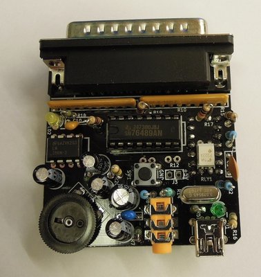

Reply 70 of 180, by dreamblaster
new prototype
The attachment tndlpt.jpg is no longer available
Thanks for your support !
Reply 72 of 180, by Super_Relay
I 100% love the volume wheel. it feels so period correct.
is it the same as the ones they advertise for repairing gameboys?

Reply 75 of 180, by dreamblaster
Solarstorm wrote:
What kind of EDA do you use?
Kicad

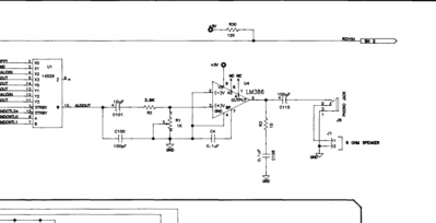

Did you choose Resistors and Capacitors for the Input Stage of the Amplifier to match the original Tandy ?
Somewhere i saw the schematic of the Tandy Amplifier Board. 😀
EDIT:
Found it.ftp://ftp.mindcandydvd.com/pub/drivers/Tandy/ … ence_Manual.pdf
Site 81 shows the Amplifier.
Lo-tech uses 470nf for Output Capacitor, you use 47uf.
And here is the Tandy 1000EX:
The attachment tandy_Amp.png is no longer available
