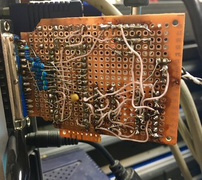

907.87 KiB
3258 views
Couldn’t wait for factory-produced one 😉
..made some mistakes designing this one, but it works. Sort of. Can be switched between OPL2 and OPL3.
Reply 64 of 278, by dreamblaster
wohoo that's fantastic 😀

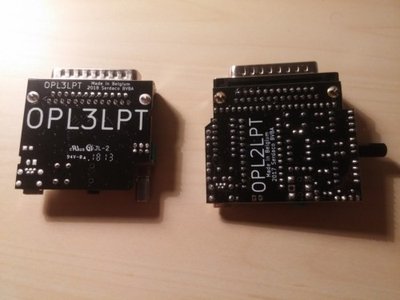

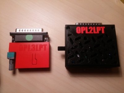

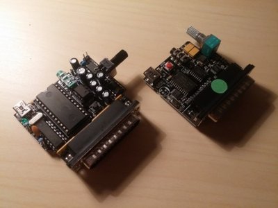

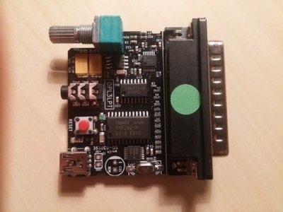

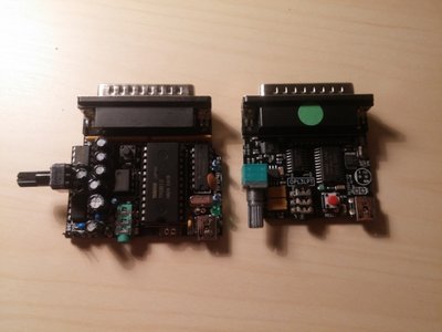

Dreamblaster sent me one of the OPL3LPT.
56.18 KiB
2485 views
I tested it on Indiana Jones and the fate of atlantis (1992) et The Legend of Kyrandi (1992). The sound is pretty well ! I use the OPL2LPT tools to run it correctly.
I really appreciate the tiny size of this new device instead of the OPL2LPT which was big.
Some photographs of the OPL3LPT compared to the OPL2LPT.
