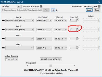

BTW, SC-VA has a nasty concurrency bug so that 2 theoretically independent instances can kill each other note's if note off messages arrive at the same moment. You can mitigate the problem somewhat if you offset the timing of the 2 instances. You can do this with FSMP + WinMM multiport VSTi by setting 15-20 ms delay for port B:
The attachment WinMMMultiPort1.png is no longer available
