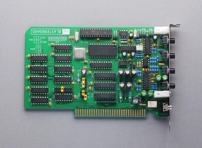

I built my Blasterboard, but I’m having issues with it not being detected, at boot. I’d like to send you a PM, but apparently I’m not yet allowed.
I did a check of the assembly, and did find one mistake, which I corrected. I’m not seeing the LED light up, and using the SB2.0 install.exe, the board isn’t detected. I have taken high res photos of both sides of the completed board. I have compared my board to the rev.B layout, from your GitHub repo, and didn’t see anything else obvious.
Can you send me a PM with an alternate way to contact you? Or, should I just post the photos publicly, and link to them?

If you post the high-resolution pictures somewhere, many people can take a look. 😀
What mistake did you make? There might be residual damage.

Thanks, Cyrix. I initially mounted IC14 backwards. Unfortunately, I don’t have a functional 74LS tester, so I can’t be sure that the IC wasn’t damaged, but it seems unlikely.
The photos are here:
https://www.icloud.com/sharedalbum/#B0i5qXGF1O4ZUq
Many thanks to anyone who wants to take a look.

What do you mean it is not detected on boot?
SB 2.0 utility may not detect it if it is run on 486 or faster machine.
Did you solder IC14 wrong at first and powered it up? It might be damaged then.
Is OPL2 working? If the led did not light up - you will not hear any sound (check T1 MOSFET if it is ok), but you can try to detect it by a game or a tracker like Edlib.
There are no obvious mistakes on your photos, so the problem should be localized step by step.

Sorry, I should have been more clear.
The machine that I am testing in is a 286/20, so speed shouldn't be an issue. I did indeed power it up, with the IC backwards, so it is possibly damaged. I'll replace it, and see if that makes any difference. However, my history with 74LS logic makes suspect that it is fine. Do you have any particular points that I should check, when diagnosing the board?
I'll try a tracker, and see if I can see it that way.

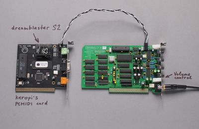

Did you know that BlasterBoard's CD input can also be used as a stereo Line input? You can for example plug in your internal/external MIDI module and control its volume manually.
Here is my current perfect combo:
