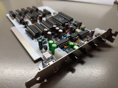

Reply 445 of 555, by bibo
Hi Eugene,
1st, I would say thank for your effort on this project.
I received my DIY kit a while ago, but in the meantime I've finished it. It looks very nice, although I prefer the green PCB, too. ... but that's ok.
It's a very nice "addon" for my turbo xt machine.
But here's the trouble...
After checking all soldering and double checking components to their correct location, I tried to commision the blasterboard in my computer.
BB claims to be compatible to the original SB 2.0 in some way. So I've downloaded the original drivers from creative . Is this supposed to work?!
1st power up... booting... , the drivers installer didn't recognize the BB at all (used: IO220h, IRQ5, DMA1).
Some restarts later, installer found the hardware. config.sys, autoexec.bat was adapted, accordingly.
Loaded prince of persia, configured sound device... awsome sound/fm music played.
Then reboot... BB is not recognized anymore: CTSND0004
After a while BB worked again. Tried to play the bbcnews.voc from samples directory. 1st couple of seconds, sound was played, correctly.
Then, I think almost at the end, the last 2 sconds of the *.voc are repeated forever. Program hangs!
I haven't tested any other programs, yet. I think, as far as I remeber, the driver (config.sys) must be installed. At least, BLASTER var has to be set.
I will test the BB in another board 386DX/40... Just to make sure, my current machine isn't broken in some way.
Is there anything I can check on the BB itself? I've got a multimeter, oscilloscope and some experience 😉
BTW:
My config: Noname Turbo XT (NEC V20, Phoenix Bios 2.27), 640KB, Trident VGA, Floppy controller on Gotek, ST-MFM controller on ST-225
BB -> IO:220h, DSP(IRQ:5), OPL2(IRQ:open), DMA:1
Regards, Bibo
Reply 446 of 555, by bibo
Did some further testings...
Installed the BB into a Pentium-style board (~133MHz) with fresh installed Dos 6.22.
Also tried to install / dignose the original SB drivers. No luck at all. Again: Maybe it isn't supposed to work?!
But I've run some mod tracker. That's working very well.
Back to my turbo xt. I still need to find a suitable mod tracker which performs on the old xt.
In the 90's, I think, I did this already on this machine with an original SB.. I have to dig in my floopy discs...

Reply 449 of 555, by LABS
bibo wrote:
...although I prefer the green PCB, too...
Yes, greens have more retro look, but after situation with pcb copying, thick solder mask is a weak, but at least some kind of protection. And I preferred white over black one.
bibo wrote:
...Also tried to install / dignose the original SB drivers. No luck at all. Again: Maybe it isn't supposed to work?!...
Which drivers did you try? SB2/BB doesn't need drivers for DOS. However, 'test-sbc.exe' will not pass, because it uses DSP's record functions which are not supported on BB. Windows 3.x should work fine with standard SB1.5 drivers. Windows 9x detects it automatically. During development BB was tested on 386SX/486DX/P166MMX/P3-1000 - DSP worked without problems. OPL2 behaves the same as on SB2. I do not have an XT machine, but there should be XT+BB users out there who can share the experience.
The card uses +5V and +/-12V ISA supplies.
bibo wrote:
...Back to my turbo xt. I still need to find a suitable mod tracker which performs on the old xt...
Check this out, XT-friendly and supports BB directly: GLX Player the only XT player ? Check Mod Master...
If you have a faster machine like that P133, try common titles like DOOM/Warcraft/Blood etc. All should work fine with OPL2+DSP combination.
On XT try something that use direct DAC mode, like KnightMare.
If you experience instability in card detection - it should be an assembly issue. Download PCB layout from https://github.com/labs-lv/blasterboard and check component placement and soldering quality as it is suggested in assembly manual.
PM me with hi-res photos of solder side of the board (do not post them here in the main thread).
PM me with any questions, will be glad to help.

Reply 451 of 555, by bibo
Thank you all for your answers.
The BB rocks in my XT, now:
1.06 MiB
1901 views
Actually, nothing was wrong with it.
I just found the correct turbo jumper (switch) 😒 . I got two of them -> [oo] [ooo] 1st one (which I missed) turns on the 12MHz , the other one decides between 12MHz/4.77MHz?!
Also, thanx goes to @eugene and @FreddyV for pointing me to Mod Master (XT). Mods are now played fine and smooth @22KHz, now.
The other thing I did, was updating the XT bios from Phatcode to version 3.1 (2017). That's amazing... I mean the XT is 25+ years old 😁
