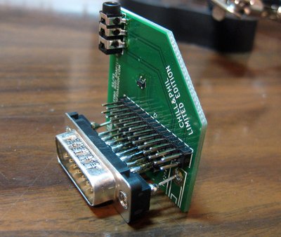

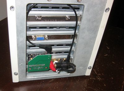

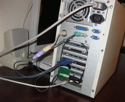

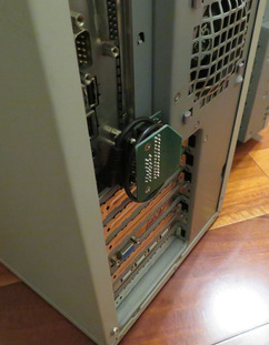

For me, one of the great disappointments of the AWE64Gold is the lack of a wavetable header. Thus the Chill & Phil midi adapter was born. This allows you to add the DreamBlaster X1, X2, S1, and S2 to the external game port of your sound card. What has always bothered me about this is that the DreamBlaster would stick out the back of the computer case. The larger the wavetable card, the further it sticks out. Shown here,

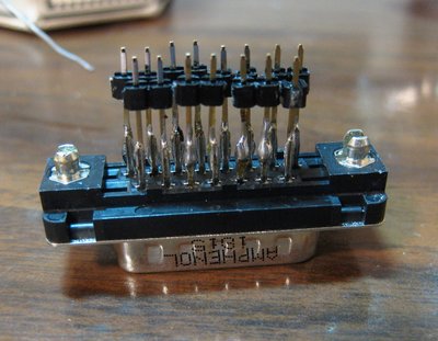

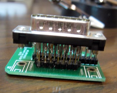

If you are like me and always move cases in and out of the closet for testing, the DreamBlaster sticking out of the back was a general annoyance, so much so that I just left it unconnected and didn't bother to use it. With the low profile of the Chill & Phil and the S1/S2 midi cards, I thought it would be beneficial to rotate the adapter 90 degrees so that it doesn't stick out any more. So I picked up a normal orientation DB15.
Unfortunately, the pins were too short, so I had to add some extension headers to it. Unfortunately, the pin spacing of the DB15 isn't quite the same as the standard 2.54 mm of pin headers, so I had to cut my headers in two's and solder them as pairs. The results are attached.

More ideal would be to make an alternate version of the Chill & Phil with the normal orientation DB15 connector on the flip side of the PCB, and to re-trace the PCB for this flipped orientation.

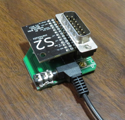

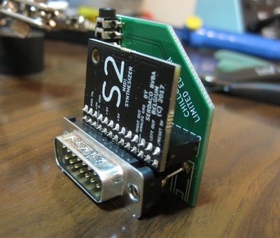

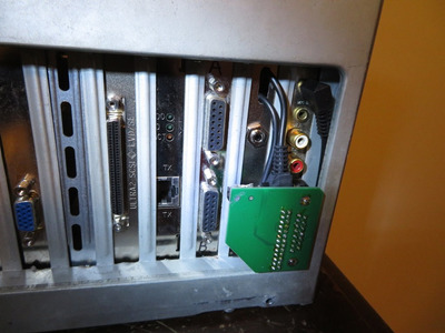

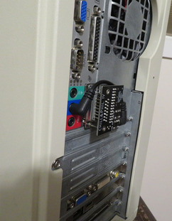

Reply 1 of 14, by feipoa
Here are the photos of the rotated Chill & Phil installed with an S2 card. The furthest point of the Chill & Phil sticks out no further than the parallel port connector on my case.

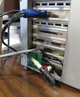

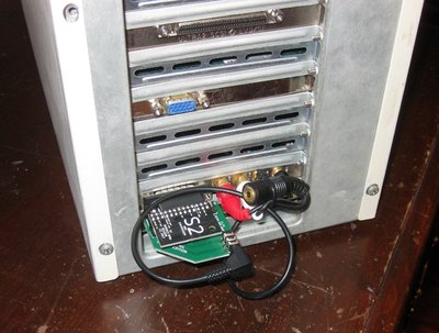

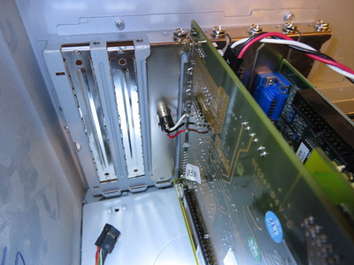

Reply 3 of 14, by feipoa
I ended up flipping the stereo jack 180 degrees on the Chill 'n Phil so that the configuration doesn't consume the next two adjacent ISA slots. If you flip it around, it only consumes one adjacent slot. This allowed for the needed space to install a game port card, since the AWE64Gold's game port is consumed by the Chill 'n Phil. Note that I needed to epoxy the stereo jack once I turned it because the strain on just the centre solder leads will rip off the pads when you insert the stereo jack.
Notice the very close spacing between the stereo jack and the AWE64Gold's input port. It is tempting to want to cut the cable and solder it to remove the excess cable.

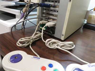

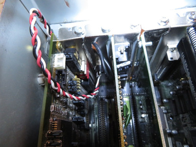

Reply 4 of 14, by feipoa
It just so happened that the 6" stereo cable fit into the hole on the slot covers, so it is nicely tucked away now.

Show that the gamepad plugs can still fit into the slot just one space away from the rotated Chill 'n Phil.

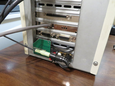

Reply 5 of 14, by feipoa
Brief update here. I decided to add a standard 3.5 mm headphone jack to a slot panel for the AWE64Gold. This way I don't need to fiddle with the RCA-to-phono jack adapter each time I pull the system out.

Small update to this thread.
I continue to pull AWE64 Gold and Value cards out of my systems. Once I got used to proper midi playback, I could not go back to the mediocre sound of any Creative audio card in DOS. I've confirmed on a second system now that the AWE64G cannot use the Chil 'n Phil properly in Duke3D. There's intermittent stutters of video and audio during game play. I tried FixMPU, but it didn't help either. I think the AWE64 series is more useful in Windows 9x or within a DOS box, but only when using the built-in sound banks.
Thus, I've repurposed the Chil 'n Phil adaptors to systems for which I'm using a built-in sound card, like my dual Pentium Pro and a Dell slot 1 Celeron. I'm pleased that the Chil 'n Phil works fine in Duke3d on the Intel PR440FX with built-in Crystal CS4236.

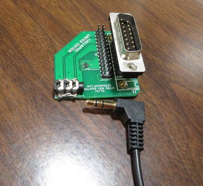

I've assembled another unit, but did a cleaner solder job. I wish DB-15 connectors came with longer leads so I didn't have to extend them like this.

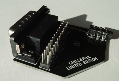

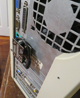

Reply 13 of 14, by feipoa

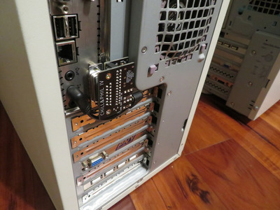

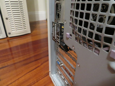

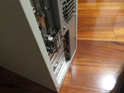

Added a third rotated CHIL 'n PHIL to another case. This case contains an integrated game port on the venerable Intel PR440FX. It only sticks out about 5 mm from the chassis.

It would be nice to have an S2 integrated onto a CHIL 'n PHIL adaptor, and with a rotated option. This would allow for very flush installations, without the hassle of extending a game port with offsets.
