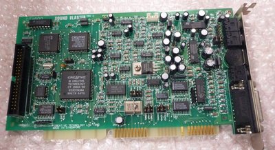

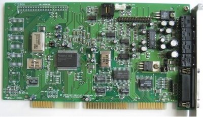

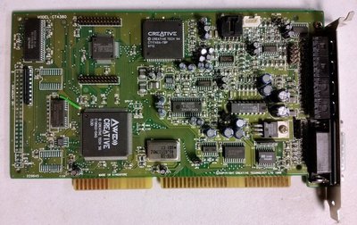

Is the Sound blaster Vibra 16s ISA with onboard Yamaha OPL 262 good enough for playing DOS games or do I need a Sound Blaster Pro 2.0 ?
How does it compare to the following ?
1) Vibra 16s
2) AWE 64
3 ) Sound blaster Pro 2.0

Of course it's good enough for DOS games. In fact, the 16S is one of my favorite creative cards out there. Also when considering the price differences, Vibras can be had for almost nothing due to overwhelming cargo cult against them 😜
1) I would say a Vibra16S is the same as a Vibra16S
2) Assuming we're talking about the Awe64s OPL3, refer to the ancient CQM vs Genuine Yamaha debate. I would go with the Awe64 for the additional midi capabilities of course, due to not being overwhelmingly concerned with clinical accuracy. If you want all sounds to be perfectly genuine, then get the 16S or Pro 2.0
3) I prefer vibra16S over the pro 2.0 (sacrilege, I know) due to having much much less line noise, and me not particularly caring for any issues with stereo. I've yet to run into any compatibility issues that have actually been noticeably annoying to me, even though I'm told regularly how much better the Pro II is.
The point of my response is to just try the card and if you like it, great. Otherwise, you'll get overwhelmed with opinions.

-Sound Blaster Pro: Yawn. There are a ton of cards that do an acceptable job at SB Pro compatibility. Almost of all of them are way cheaper than a real one.

Vibra 16 is as good as a SB16, does anyone really use the Bass/Treble settings on their SB16's? (as thats the only real difference)
AWE is a SB16 with the EMU chip, so really this is the better choice if you already have it. but if your games don't support the AWE as a music device it'll be no different.

I bought a Vibra 16S by mistake a few years ago and cursed my error when it arrived. However, after installing and running it, it sounded just fine. I don't understand the hate against them.

Some Vibra16 cards are PnP and some are not.
There are models with OPL3 and models with CQM.
Models with or without high-DMA support.
Models with the hanging-note bug or without it.
And some Vibra16 cards support bass/treble regulation.
I personally like PnP as it allows me to reconfigure cards on the fly and I also prefer OPL3 to CQM.

This has been my experience as well, it baffles me how so many people call the Pro 2 a "silent" card. I had one for several years during the 90s (it was my first sound card) so it's really nostalgic to me, and currently I own two, but each time I use them I cannot stand the line noise compared to a SB16.

Pros are quiet on older motherboard made by solid brands, cheap clones from late nineties have shit supply rails filtering and you will hear it on Pro (interrupts when moving a mouse, hard drive, etc).
