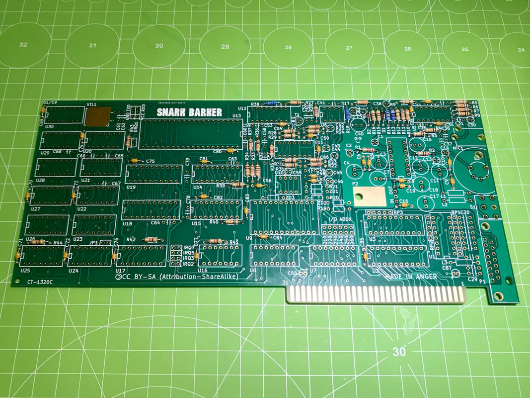

Good news, I sourced the resistor networks, and ordered some SAA1099 chips from China. I now have everything except the Alps potentiometer that seems impossible to source for me yet, so that will be my next problem. Maybe I can find a way to temporarily bypass it?
For now, I've started soldering onto the board. Here is where I am after two days of work: (Yes, I am a noob and slow 😁 )

Oh wait, you were not kidding, the reference image actually DOES have 4 2.2KR THT resistors! And it doesn't look half bad, I really didn't need to sweat it this much. 🤣

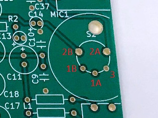

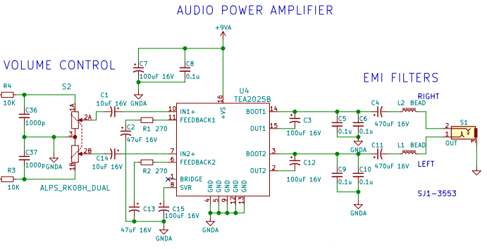

I don't hink it's a very simple bypass, the board uses a dual gang potentiometer.
What I can make of this circuit schematic is that I can solder two 4.7KR resistors between 1A-2A and 1B-2B, the connect 3 to Ground and have it at 50%? Obviously as it is reverse logarithmic I would probably get what, 30% or so? Alternatively I could use an 8.2KR and 2.2KR but I don't know which one should go where to get around 70% volume..
I followed the traces to label the terminals above..
