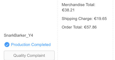

Reply 450 of 497, by root42
My 10 PCB SnarkBarker order was roughly 60 EUR including shipping, with ENIG. How are the prices today? I find 6 EUR per PCB pretty cheap, considering the large size of the SnarkBarker.
23.3 KiB
1130 views
EDIT: Current price is 5 EUR per PCB w/o shipping. So 25 EUR for 5 PCBs, plus shipping. Should be less than 50 EUR in total.
PS: Make sure to choose chamfered edges or gold fingers, which makes the card fit better into the socket. It's not strictly necessary though.

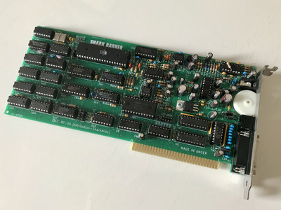

In other news, the replacement AT89S51 came in the mail, flashing went smoothly and it is now on the card in its socket. I will be trying the card tonight. Cross your fingers for me guys, you may FINALLY get rid of my whining once and for all!
Reply 453 of 497, by appiah4
Initial testing on my Celeron 1333 system is a partial success. Adlib, CMS and PCM audio all work (NO MORE DISDTORTION!), but whenever I launch any game that has digitized sound (ie uses DMA) there is a constant repeating clickling in the background (click, click, click, click..). Could this card be speed sensitive and maybe this Celeron 1333 system is too fast for it?

Reply 456 of 497, by appiah4
Happy to report that the card works flawlessly in my 486.
Reply 457 of 497, by root42
At last! Congratulations! And what a nice bracket! 😀
YouTube and Bonus
Reply 458 of 497, by appiah4
More photos, just because 😀
Tube-Time-Snark-Barker-01.jpg Tube-Time-Snark-Barker-02.jpg Tube-Time-Snark-Barker-03.jpg
Tube-Time-Snark-Barker-04.jpg Tube-Time-Snark-Barker-05.jpg Tube-Time-Snark-Barker-06.jpg
And many thanks for the wonderful bracket again @root42
