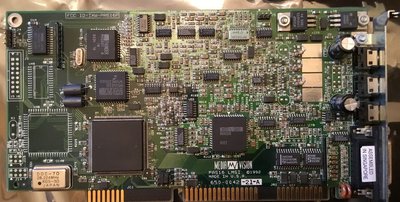

I don't have my original PAS16 anymore, so I went to Ebay and found one. It arrived with a bit of corrosion on the bracket and the I/O ports. No problem, the bracket cleaned up nicely; the game port is a standard footprint and was easily replaced; the audio jacks are too -- except there are a few different common heights, and the exact match was NLA from the parts houses. So I got something close and figured I would enlarge the holes in the bracket to accommodate. Well, then I had no end of issues with the card.
For one, it took a while to resolve all the resource conflicts, but eventually I got Win95 to select a config where everything worked. Then I ran into the second problem.
The sound was barely audible, and running MUCH too fast. Some research indicated that the speed issue was a known side effect of not having a -5V rail. Sure enough, I was using an ATX supply with an AT converter cable. After securing a standard AT supply, that problem was solved.
The sound was STILL barely audible, though. Crackly, whisper quiet, heavily distorted. Huh. Maybe I need to replace the caps? So I did. (Need to swap them out again, though -- the larger values I had on-hand were too high on the voltage rating, and thus physically too large to fit in a single slot form factor.) No help -- sound was still quiet and terrible.

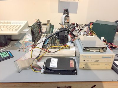

Then I read a post where someone mentioned off-hand that the PAS16 had an odd grounding scheme, where the audio ground was actually tied to the bracket and grounded to the chassis when the card was installed. Well, mine was still missing the bracket! So, I finally got around to testing this theory out.
Don't mind the disaster area of a workbench here...
267.29 KiB
714 views
In this case, I just used an alligator clip to ground the bracket fastening pad to the AT keyboard port. But, this was a hybrid AT/ATX board, and I was using another ATX supply without -5V, so I had to improvise:
234 KiB
714 views
Some day, I might create a short ISA card that back-feeds -5V from the -12V rail. It would come in handy in cases like this.
At any rate, I can now report that the PAS16 is FULLY functional, and works like a champ! 😎

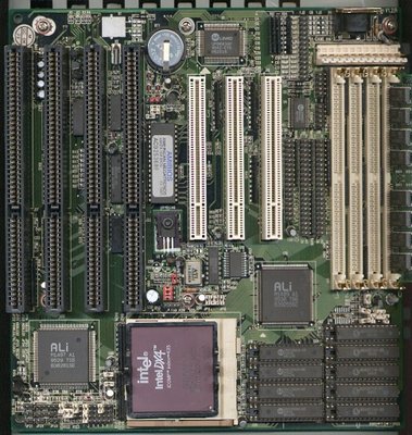

I just ran into this same problem.
The PAS16 worked fine in my ATX 486 socket-3 motherboard ( PCchips M918i ) running Win95c with vanilla drivers , but NOT in my ATX Asus P3 motherboard running Win98se.
