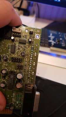

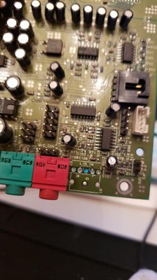

While we were testing the analog part of our prototype card, we've come across some problems with the mixer. We started to debug it, compare our schematics against the original CT4520, etc. etc. etc., and finally discovered some strange behaviour of the Line In jack on CT4520. In fact, it did mono while it was clearly supposed to be a stereo input. CT4390 acted the same. We've become curious, traced the signal, and had to desolder the jack, and...
111.8 KiB
2888 views
...we've found a jumper trace there, shortening L and R channels of the stereo input! Meanwhile, when we desoldered the Mic In, in has turned out to be "stereo":
103.3 KiB
2888 views
So, Creative has clearly confused the Line-In and Mic-In jacks on the board, despite the silkscreened markings! What a shame! And all you users who tried to feed the output of your GUS/TB/Rolands/etc. into your AWE64 (no matter if it was a Value or a Gold), in fact got pseudo-stereo due to this error. Moreover, when this trace is cut, the Line-In functions perfectly as a true stereo input.[/i]
"L" and "R" refer to both solder points each, that's why the silkscreen is centered. And as you can clearly see from the other connectors, the outer two pins are the stereo channels, the inner ones are GND. Connecting the two GND lines does not turn stereo into mono. How can you even think Creative was that dumb and no one ever noticed that line-in is mono only in the past 23 years?
Oh yes, they were. We couldn't believe our expectations too. The inner and outer pins are shortened in pairs (on all 4 jacks), and this jumper on the Line-In make both L and R pairs shortened too. Feel free to take a card and test it yourself.
