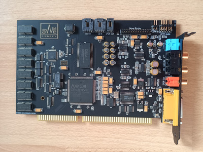

Reply 756 of 782, by pietja
It's a bit late but I finally got time to build my PCB version of this card.
I got it working but the EEPROM is still showing up as "Creative SB AWE64 PnP"
I have run the EEPROM update in the production package named "upd4520.exe" but that didn't change anything.
Here is says the updated EEPROM should show up as "AWE64 Legacy" but I can't the firmware for the EEPROM to do that anywhere?
So where do I get the EEPROM firmware to flash my card to show up properly and also so that Unisound can properly initialize it? because it has special support for it with the proper EEPROM.
- AWE64 Legacy: Only for this card, when its unique PnP ID is detected,
Creative FM is now shown as "CQM". Also if CQM is remapped to a port
different than 388, and an OPL chip is detected at 388h it will be shown.
I would also be happy with just a binary dump anyone could make using AWEDUMP of the EEPROM so I can program it using AWEFLASH

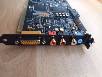

Reply 757 of 782, by pietja
I finally finished my card today and reading the notes about the dip-switches being fragile I glued them to the board with epoxy before soldering them.
Also I used colored connectors to match the PC 99 color specification, the donor card for it came from the dumpster at work that is why there is a scratch mark on the main chip 🙁
1.62 MiB
