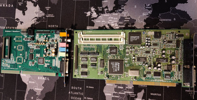

Got mine last week. Finally managed to play around with it today.
Actually had almost "oh s*it" moment.
Started my Win98 P3 in Dos 7.1 mode and initialized card with unisound.
Card initialized correctly.
Decided to start testing safe - with OPL3 player http://adlibtracker.net/
Fried up included ADT2PLAY.EXE which have worked with all my OPL3 cards and ... ...loud static noise and PC hung....
Then went to test all other features including adlib (388) support in games - card passed all tests with flying colours.
It actually turned out that adlib tracker player has special (fix latency) command line parameter. With that parameter card worked just fine.
Also Keropi I'm somewhat impressed how you have managed to streamline your team production - delivery pipeline in context of high demand. Ordered in May got it in October. A lot faster and robust compared to Sony with PS5 delivery. 😀
So SB32 out, Orpheus in:
678.74 KiB
2250 views
