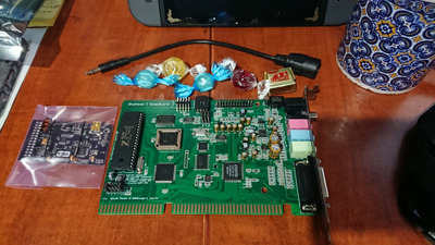

Reply 890 of 1061, by IcySon55
A giant thank you for being awesome @keropi
It just arrived along with the goodies! Can't wait to take it for a test drive~

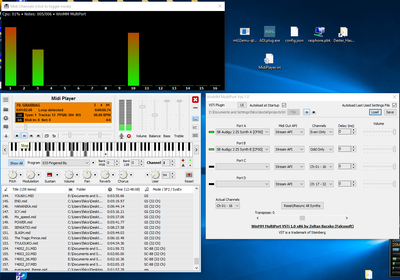

Reply 894 of 1061, by Falcosoft
Kahenraz wrote on 2022-04-27, 04:52:
I've heard that it's possible, but I haven't found a way to do it.
I have just written a soon to be released special/fake VSTi plugin for FSMP (WinMM Multiport VSTi) that can do this among others:
@Edit: A test version can be downloaded from here:
https://falcosoft.hu/midiplayer_61_test.zip
More Info:
Re: Falcosoft Soundfont Midi Player + Munt VSTi + BassMidi VSTi
    232.97 KiB
    1311 views

Shreddoc wrote on 2022-04-27, 11:37:
Touché! Cool stuff. Good idea about the channel filtering - simple and effective.
Thanks 😀 Although the credit goes to @Cloudschatze, I just built upon his posts.
