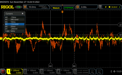

Update: It seems to be indeed Unisound specific. After playing around with unisound switches I found out that if I initialize card with enable SPDIF Flag is sets volumes only for digital output. Well that's logical. So my initial test results isn't that relevant because analog output just had random level for Wavetable - probably default 80.
So I decided to play around with Orpheus SPDIF out feature. Went for cheap 15EUR one which seems to be based on AD DAC841 chip. Everything seems to be working fine. Orpheus analogue out implementation is little bit more base heavy compared to DAC. However I am having issues with Serdaco E-Wave wavetable attached to Orpheus digital out volume.
Use case - Tested with Doom and Descent2 music - First tuned my external mixer so that SB/adlib FM has exactly the same levels from both card analogue out and external DAC digital out. Confirmed levels also with game digital sound effects part. However after switching game output to GM(E-Wave) device while card analog out is more or less on the same level, but digital out is a lot quieter.
Hooked it up to my Oscilloscope to get more "scientific" evidence. See attached pic. Orange reference waveform is analog, yellow is digital.
I'm using Unisound. Looks like it has common volume parameter for FM and Wavetable. I cant tune Wavetable digital out separately. What I'm missing here?
Also I have "poor man" version without PCMIDI part in case it might be relevant...

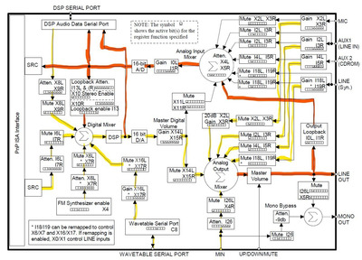

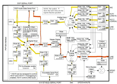

Hello!
FM and wave table are indeed tied. As they both are treated as "external synth". It's the way SB and crystal chip works. So when you change volume on synth, either Wavetable or FM volume change to the same value. As for analog output and digital output they are routed differently, so audio levels may be different. That also depends on how software (unisound) routes the audio, I know that SPDIF on Crystal goes out before entering DA converter and go to output mixer. But after that many things can happen with unisound software, I don't rememder how it routes the audio. I would advise you to test orphinit. Both software are great, but orphinit is intend to mess more with Orpheus Card.
Next is an example , exposed before , from what Crystal chip can do:
Orange = output , Yellow = Input
The best way of routing
245.84 KiB
1055 views
Not the best way of routing
255.97 KiB
1055 views

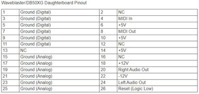

Btw. more technical question regarding SPDIF output and WT output implementation. If the WT pinout schema (attached) is correct then there doesn't seem to be any I2S type of outputs for digital audio. Does it mean that CS4237 will take WT analogue out signal and convert it to digital format?
    53.83 KiB
    878 views
Reply 968 of 1001, by keropi
Yes, WT audio is analog and it gets converted to digital by cs4237, this happens with all analog sources.
What you have is the decades old issue with wt boards, it's the reason some people used 2 soundcards or a midi interface to get 2 MPU devices or just went fully external with midi.

Thank you 640K!enough for your detailed replay. I actually found out good suitable .ini setup for WT levels with ORPHINIT in WSS mode, but then yeah I realized that software(games) more often than not will reset everything as soon as I choose SB for output.
Still thank you for your effort.
