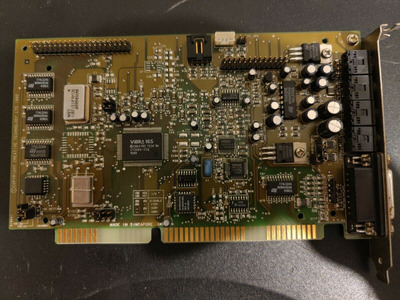

I recently received a Creative CT2900 (Vibra 16s) and had the issue of diagnose.exe not finding the MPU-401 at addresses 300h or 330h (so no MT-32 in games!). This driver solved the issue and the port became usable.
Pentium 90 Mhz, 32 MB EDO RAM, Matrox Millennium II, Creative Vibra16s (DOS 6.22/Win 3.11 & Win 95)

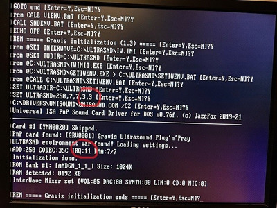

I can't set IRQ 3 for GUS PnP. It defaults to IRQ 11 instead. IRQ 7 was properly set. I did not try IRQ 4 or 5 since they were in use.
117.83 KiB
2607 views
Reply 442 of 631, by BloodyCactus
IRQ 3 is usually the serial port. if you have not disabled it in the bios, it cant use irq3...
Reply 443 of 631, by aitotat
I have disabled serial port 2 so IRQ 3 is free. I'm not sure but I think I had parallel port enabled (IRQ 7) when I tried to test IRQ 7 for GUS PnP and that was set properly.

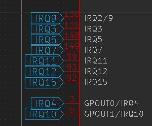

Just a little side-note concerning this: the Interwave is technically able to accept the following IRQs on its pins (so it might be possible to limit them to these options):
17.47 KiB

@MJay99 yep, I know, in fact, even some IW accepted IRQs could cause issues with some games/demos. It's up to the user now.

Gus PnP now works with IRQ 3. Unisound is far better and easier to use than iwinit. Unisound sure is great. I once avoided PnP cards but thanks to Unisound, I now prefer PnP cards because it is so easy to reconfigure the cards and set volumes.
