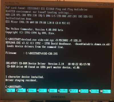

Did anyone try to attach a CD-ROM to the PnP IDE interface on the sondcard (initialized with Unisound) ?
I have an issue with the ESS1868 cards. However, the Сrystal CX4237 card works fine (with the same software and CD-ROM).
1) Working card: Сrystal CX4237, CD-ROM DRIVE, UNISOND, DEVLOAD, VIDE-CDD.SYS 2.14, MSCDEX
2) Non-workng cards: ESS1868 (all cards give the same effect),CD-ROM DRIVE, UNISOND, DEVLOAD, VIDE-CDD.SYS 2.14
(I've made a long image since forum won't attach more then 5 files)
Reply 562 of 638, by 1541
@alec_v did you also try address 168 and/or IRQ 10 on the ESS?
The IDE interface can be configured to run at I/O address 168h or 1E8h, and use IRQ 10, 11 or 12.
https://dosdays.co.uk/topics/Manufacturers/ess.php

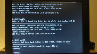

Hi,
with current version of Unisound Terratec Base-1 does not longer initialze. (0.80, 0.77 doesnt work)
with Version 0.65 it works just fine.
Something is broken here.
https://www.philscomputerlab.com/terratec-pro … dia-base-1.html
Old Version attached, in case something has the same Problem.
It seems there is no version archive ?
    UNISOUND065b.ZIP
    32.09 KiB
    114 downloads

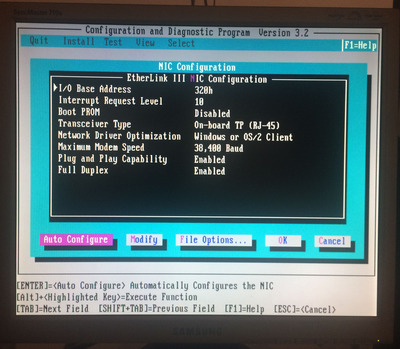

Reply 564 of 638, by alec_v
1541 wrote on 2023-02-06, 19:37:
You are right, 3'rd IDE address works for the ESS1868!
I can't use 4'th IDE since I have a 3C509 card on the IRQ10
Reply 565 of 638, by zyga64
alec_v wrote on 2023-02-13, 20:11:
If you are not using serial COM2 port, you can disable it and set 3C509 card IRQ to IRQ3.

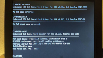

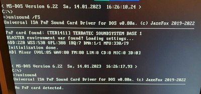

Reply 567 of 638, by matze79
(Quote from Ranger85 / dosreloaded.de / Terratec Base 1)
I have now made screenshots. In each case with the current version 0.80 at the top, followed by 0.76 and 0.65.
157.77 KiB
2414 views
I tested in three different systems:
- 486DX4 100 MHz, SIS 471
- 386DX 40, Symphony 82c461
- Pentium 90, Intel Triton
In all three systems the exact same behavior, no matter if with auxiliary parameters from the readme or without.
I have the Base-1 twice. Makes no difference which one I use.
For comparison I took my Highscreen Sound-Boostar 16, with which it works in the new version.
This card is based on exactly the same AD1816 chip and does not differ at all from the Base1.
The old version 0.65 detects the card, but can't do anything with it.
179.98 KiB
2414 views
My guess: The bug in the new version could be related to the PnP ID.
It doesn't seem to reveal source codes, so it's not possible to check if it's just a typo etc..
(Quote / end )
used Deepl to translate it for you.
I also can reproduce the same with my Intel Triton based Pentium.
i don`t see any point to remove something old that works.
It would be much better to keep each release around, for exactly such purposes.
imagine cutemouse would remove all old versions.. some newer don`t work proper with dos + windows 3.x in some systems.

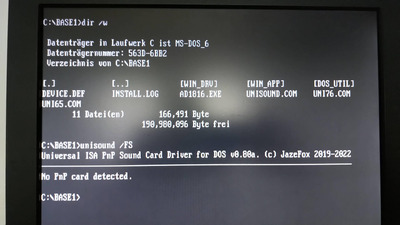

Reply 570 of 638, by JazeFox
matze79 wrote on 2023-03-06, 20:08:
@mazte79 @MJay99
Hi!
Thank you for all the testing, photos and details!! This will help to find the problem for sure!
It's not a PnP ID problem (In such case, the message Unknown card [XXXXXXX] .... should appear).
I suspect of some EEPROM brand differences that causes this problem in newer Unisound versions with ADI chips (and some very old cards of different brands). Please, can you test v0.80 this way?:
UNISOUND /FS
This should help a bit if that's the case. Let me know if it works. If not, I will release a new test version with some changes in speed for the detection phase in those cases.
About keeping the old version, no problem with that, it's OK 😀 I thought that the best way is always to have the latest version the best possible, with all bugs found and fixed, and the point in my request was only about that, trying to avoid confusion to new users with a mix of old versions that have bugs that should be avoided. As I try to give help and support regularly in order to provide a good program for everyone in the latest version, in theory, old versions are not needed. But I could be wrong, of course.
Let me know the results and we'll continue with the investigation with the details provided. Ah! I forgot to ask... could you check the EEPROM chips in the tested Base-1 cards? (Shoud be a 24C04) , and the brand? ATMEL, ST, ISSI, ATC.... ?
Thanks.
Reply 572 of 638, by matze79
164.22 KiB
2246 views
116.87 KiB
2246 views
Atmel 24c04 EEPROM

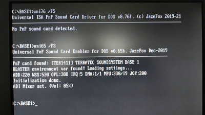

Reply 573 of 638, by MJay99
@matze79: Now that's really interesting... I went back, just to verify and having proof that it really is working with 0.80a:
89.59 KiB
2222 views
This is on a 486DX2-66 VLB system, with nothing much of a PnP BIOS support otherwise.
Both cards I have (one repaired, one in original condition) do initialize this way.
Did you also try the /XXF option JazeFox mentioned a few posts back (Force detection of PnP cards with a partially corrupted EEPROM data (bad header checksum))?
Unless the older version did this implicitly, it probably might not help much... but still doesn't hurt to give it a try 😀
And maybe as a hail mary : /XNET (It's a workaround for Realtek (and compatible) ISA PnP network cards when paired with other ISA sound card(s).)
Reply 574 of 638, by matze79
It works on 386DX40 with Parameter but does not work on P90 / Triton.
Maybe it’s timing related?

matze79 wrote on 2023-03-17, 21:14:
The problem with some Terratec Base-1 cards has been located, being a mix of AD181x + EPROM model + Chipset/Chipset timings, and a workaround will be released in the next version. Note that very old (like v0.65) init and detection routines will not be used because it would be a big step back, as it would break support for a lot of cards and software that was added with later versions. But, no worries, In the next release, the standard init (without parameters) will address 99% of the problematic "mixes" of AD181x, and the other 1% (as the rare combination of some systems with Intel's FX + some ATMEL EPROMS) will be solved using a new parameter with a slightly different and slower method.
