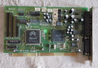

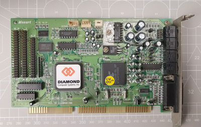

Reply 430 of 639, by aigeek
Diamond Mozart OPL3 ISA PNP Sound Card don't be supported by Unisound v7.6f
The card is working with factory driver, such as 601b112. The download links paged by Phils https://www.philscomputerlab.com/btc-1820-moz … oak-oti601.html
The host:
Intel PIII-1000EB / 440BX
MS-DOS 6.22
Matrox G450 DH PCI
onBoard Adaptec AIC-7895P disabled
(No other cards)
The card model:
Diamond Computer Systems IDW30601206 S601206-A
(Mozart BTC-1820)
811.27 KiB
2331 views
296.53 KiB
2331 views
The chips:
- Mozart OTI601 (OAK Technology)
- CS4248-KL (Crystal Semiconductor)
- YMF262-M (Yamaha)
The message by Unisound v7.6f:
Universal ISA PnP Sound Card Driver for DOS v0.76f. (c) JazeFox 2019-21 -------------------------------------------------------- […]
No PnP sound card detected.
The Dumpp data:
DUMPP(Mozart_BTC-1820).zip
52.32 KiB
60 downloads
Reply 431 of 639, by Tiido
OTI601 has no PnP support, it has only its own custom jumperless configuration like some OPTi cards and many others that predate the ISAPnP spec. Later OTI605 adds PnP support.
Reply 432 of 639, by aigeek
Tiido wrote on 2021-11-08, 02:48:
I see. And it looks more complicated, the card fits the OTI-601B driver, but not with OTI-601E and OTI-601F driver. How to identify the version of OTI-601? http://www.plasma-online.de/index.html?conten … re/oak_oti.html

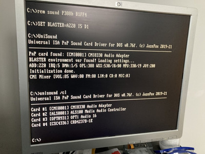

Reply 433 of 639, by S_crumb
I just wanted to pop in and thank Jazefox for making this program. I just spent hours trying to get the original SB16 drivers to work with my setup. I ran into an odd bug that I just couldn't quite resolve. 3 hours later and being no closer to the solution I thought, "Why don't I just try Unisound?" 10 minutes later it was working flawlessly. Literally the only thing I had to do was read the Unisound.txt and figure out how to set the CD volume. If I would have just started with Unisound, I'd have so much of my life back!
Absolutely couldn't be any easier.

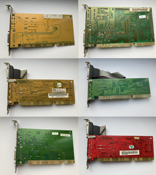

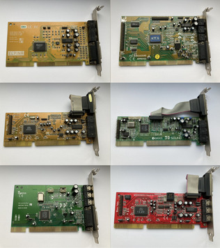

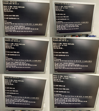

The author of the program is absolute genius!
Tested with 6 random ISA sound cards — 100% success with UniSound [some of the markings on the chips were strange to me]
