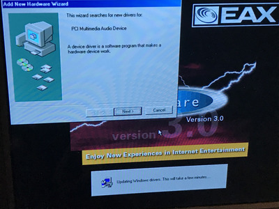

I was feeling masochistic yesterday, so I decided to try to match various Sound Blaster Live! cards I own with installation CDs found on vogonsdrivers and archive.org.
What I was looking for is a 100% smooth install in 98SE with the CD only. No downloading additional drivers or even pointing the installation routine to the location of the proper file. And, of course, the Live! card had to work as it should. You know that there is not a match when, during the install process, an Add New Hardware window like the one below pops up.
1.02 MiB
4899 views

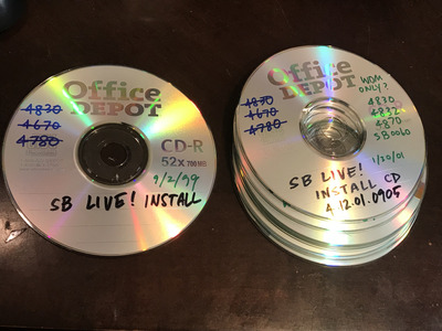

In the past, a 100% smooth install has happened only when I used a boxed retail version of a card with the CD that was packaged with it. I had retail CDs for CT4760 and SB0060 but sold the latter.
I figured that among the dozen or so .ISO images on vogonsdrivers and archive.org, I could find a match for my other Live! models (CT4670, CT4780, CT4830, SB0220). The information on vogonsdrivers is not 100% reliable; the description might say that it works with CT4830, for instance, but it didn't with my card.
So, I did a trial and error experiment. I differentiated the CDs by the date of the CD's folders (because some files in the CD's root directory have different dates). For each model, I did a clean OS reimage (98SE) after each failed install, then moved to another CD. You can see how I kept track by crossing off model numbers on each CD:
1.19 MiB
4899 views
In the end, after trying about nine different CDs (with different dates for the folders), I could find a match for only one model: CT4670. The folder date for this one is 9/3/98, and I think it is on vogonsdrivers.
If anyone has a CD that 100% came with a Live! model, please post to this thread. Thanks!

A partial success! The CD works with a CT4780 perfectly -- a 100% smooth install.
Although I had a 100% smooth install with the CT4830, I could only the faintest of sounds in Windows or DOS. If I cranked my speakers, I could barely hear sound. I tried two different CT4830 cards in two different 98SE setups (440BX-2 and KT133A).
So I don't believe looking at the INF file only is an accurate way to ascertain compatibility. Of course, there could be different versions of the CT4830. I couldn't find the Device and Subsystem ID in Device Manager, but Everest Home displays it. There's a match for the CT4780, and I haven't looked at CT4830 yet.
It makes me wonder if I could get it to work by renaming the INF files. Maybe when I'm feeling more masochistic.

I'm pretty sure that a driver incompatibility is why the CT4830 did not work. You see, I started with the CT4830, got the 100% smooth install, but then no sound. But rather than reimage the HDD right away, I popped in the CT4780 (after trying another CT4830, as stated earlier), and it worked perfectly.
So I went into the registry and discovered that only two of the subsystem ID's from your post are listed:
CT4780 - SBLive! Value (PCI\VEN_1102&DEV_0002&SUBSYS_80221102)
CT4831 - SBLive! Value (PCI\VEN_1102&DEV_0002&SUBSYS_80311102)
Also, the 8021102 is rev 08 and the 80311102 is rev 07.
No IDs for the CT4830. It's possible it would appear if I installed the CT4830, which I may do, but it would explain why the CT4830 doesn't work.
I didn't realize that different revisions might have something to do with compatibility. Looking at my two CT4830 boards, I see two date stamps on the reverse, upper-left: 3599 (35th week of 1999?) and 500 (5th week of 2000?).
