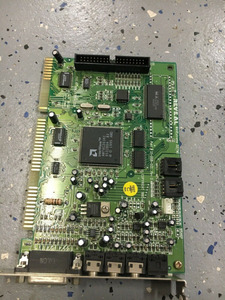

I just picked up this beauty recently. It has one damaged component (a ceramic cap near the memory chip) but otherwise looks great. My PC running Windows 98SE detects the card, which is a good sign.

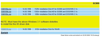

I'd really like to find the original drivers for it. I haven't tested the generic Interwave 9x drivers yet, but I found this page specifically for this card:
http://files.mpoli.fi/unpacked/hardware/sound … ther/sc800.zip/
Sadly, the link on that website that goes to the unpacked Win95 driver file is broken, the SC800.zip file is there (under hardware) but it does NOT contain the Win95 files! Also, the wonderful mirror of this FTP only covers the "Hardware" portion, rather than the unpacked files. 😢
The page says:
NOTE: Must have the above Windows 3.1 software diskettes to install the this 95 driver disk.
13008110.zip 627k 14.05.96 Installation Disk for Win95
If anyone has this 13008110.zip file, please upload it or link to it here! 😀

Amazingly, everything seems to work great! I get a bit of a popping sound after digital samples are played some times, but overall it works great. For only a 1MB ROM on a fairly basic card, the synth sounds excellent for MIDI playback as well. I'm not sure exactly what the damaged capacitor is for since the card is mostly working fine. Maybe I should just replace it with a random cap of similar size. There's no way to know what it was supposed to have.
I don't know much about GUS or Interwave cards. Since this card has 1MB ROM (as identified by the GUS software) and has no RAM slots\sockets, am I limited on what "Ultrasound" features this card can use? Seems like anything that would use an Ultrasound's RAM would not function on a card like this.
Since the card has no RAM, and no option to add any, its compatibility with traditional GUS software will be almost non-existent. Furthermore, some features of its wavetable playback, including effects (reverb/chorus) won't be available, as they require RAM-based storage as well. Putting an InterWave on a board with no RAM is a bit of an odd design decision.

Your card reminds me of the STB Soundrage 32, another Interwave card. I cover it in this post (scroll down about 10 cards or so): Re: My Wavetable Sample Thread
The interesting thing about the card you mentioned is that it looks like there might be a footprint for one SOJ DRAM chip. I have no experience with that particular card, but it looks like a possibility, from your low-resolution picture of the board. You'd have to carefully check where the traces go from that footprint to be sure before trying anything, but 512 KiB of RAM would make the card much more functional.

I know this is old but was looking for all the SC400 and SC600 files I could find and stumbled on "13008110.zip 627k 14.05.96 Installation Disk for Win95" thru way back machine off a BBS mirror, and it tests OK with 7zip.
from the sc800.inf:
