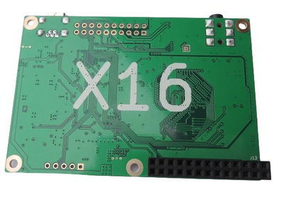

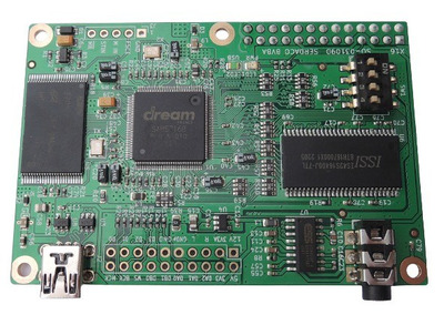

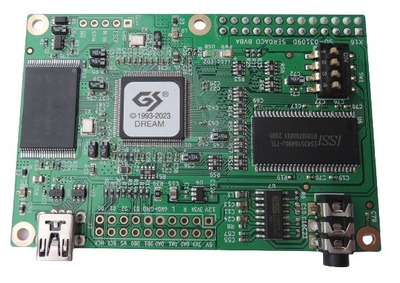

    85.11 KiB
    118 views
    56.28 KiB
    118 views
    85.2 KiB
    118 views
