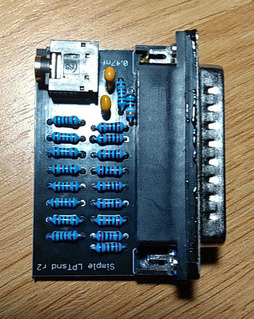

Reply 3 of 20, by matze79
There is Adlib Replica for MCA.
Or you can just use OPL2LPT or OPL3LPT.
I use mostly LPTDAC.386 / Covox Driver for Windows 3.1 on my 55SX with a simple Covox Device i made.
150.61 KiB
1859 views
And also a OPL2LPT from Serdashop for FM Music.
