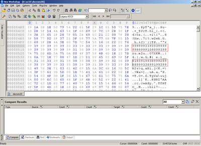

hmm, applying MT-32 bit-swapping to SC55ROM results in really interesting patterns (and they repeat and repeat through the whole data stream) - screenshot attached.
so, maybe bit-swapping of SC55ROM is the same as MT-32, but we have also byte-scrambling, i.e. each byte is on a wrong place like with CM-32P...

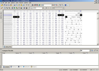

"IC23" ROM contains 2 demo songs as well "Jazz Lagoon" - at offset 0x88ac and "Leya's Song" at offset 0xd174 - they are stored as complete MIDI files with header and everything. So, you can just copy the byte sequence and paste it to a file. Also, I found the related portion of "IC23" ROM H8/500 assembler code - it's pasted below. If by any chance the descrambling algorithm is in IC23 (and not in IC30), then we still have a chance ...
ROM:74A8 ! ---------------------------------------------------------------------------
ROM:74A8 mov:i.w #0x88AC:16, r4
ROM:74AB cmp:g.b #0:8, @byte_CF8C:16
ROM:74B0 beq loc_74BF:8
ROM:74B2 mov:i.w #0xD174:16, r4
ROM:74B5 cmp:g.b #1:8, @byte_CF8C:16
ROM:74BA beq loc_74BF:8
ROM:74BC mov:i.w #0xF37F:16, r4
ROM:74BF
ROM:74BF loc_74BF: ! CODE XREF: ROM:74B0j
ROM:74BF ! ROM:74BAj
ROM:74BF add:g.w #0xC:16, r4
ROM:74C3 ldc.b #4:8, ep
ROM:74C6 ! assume ep:4
ROM:74C6 mov:g.b @r4+, r0
ROM:74C8 mov:g.b r0, @byte_CF8A:16
ROM:74CC mov:g.b @r4+, r0
ROM:74CE mov:g.b r0, @byte_CF8B:16
ROM:74D2 ldc.b #0:8, ep
ROM:74D5 ! assume ep:0
ROM:74D5 add:g.w #9:16, r4
ROM:74D9 mov:g.w r4, @word_CF84:16

Reply 108 of 377, by yawetaG
What's interesting about demo songs on many hardware units is that the synth often does not output MIDI data while playing back the songs, even if ostensibly the songs are stored as MIDI data in ROM - probably a form of copy protection. I guess it will be the same on the Virtual Sound Canvas.
