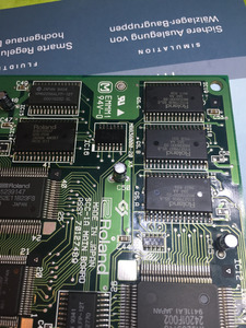

@Mattw: I did the readout on SCC1 Control ROM, and yes, it is byte-exaclty the same as kitrinx SCC1A_R00128567_GS4-PRM_v4_(program).BIN.
Resoldering was successful, but i am not shure, to do such a hazard again 😀
    1.65 MiB
    2155 views
    Desoldered roms resoldered on SCC1
Reply 287 of 377, by mattw
Alex-aut wrote on 2020-12-17, 19:59:
Caps C51 C52 exploded on desoldering, but this will not be a problem
they are just bypass caps, it will work without them. It was unfortunate that the SCC dumps were shared at the same time you desoldered your roms.
