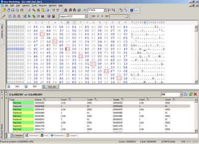

hmm, when i visualized what is going on, i got the relation, but partially - it's diagonal and every next byte on the diagonal, that's why when I replaced only 16 bytes with fake one there was no any relation, because you need to have matrix with at least 16 bytes diagonal and that means 16 lines or 256 - exactly why the magic happens when I replaced 256 bytes with fake one. I am definitely getting closer....
[EDIT] searching for "encryption diagonal matrix" gave link to "Modifying des algorithm by using diagonal matrix based" - I don't know maybe I am reinventing the wheel, but I don't think Roland use DES - I mean I see no key, i.e. no byte change, just the bytes are shuffled in this weird and very hard to understand way.

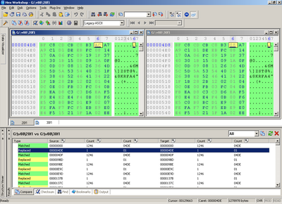

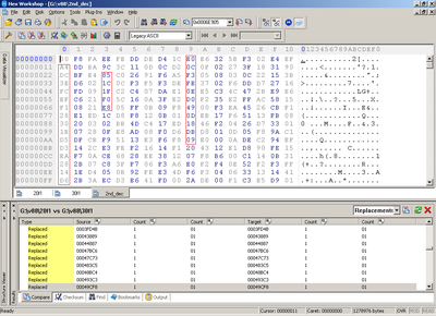

back to the 2nd block and its 2nd layer of encryption (really very complicated byte shuffling??!!)...
Guys, I really don't know what is that - if I make the matrix with 16 elements in a row, then it acts on "column" instead the "diagonal" from the picture attached 2 post above. The problem is that while on "column 0" (see the attached screenshot to this post) it acts on all elements, on "column 3" and "column 9" it acts only on some elements. it makes no sense to me!
also on some of the elements it adds or subtracts "8", below are details what it does on "column 3" (in full details to understand what exactly happens) and for column0 and columd9 (i put just a short table, you can read it, based on column3 detailed explanation).
Anyone recognizes this? Is it just shuffling or some well-know (and complicated) cryptography algorithm?
(0x8d - 0x08) = 0x85 --> value of "0x85" is assigned to address  (0x6EDE4 + 4DF*0)
(0x1c ) = 0x1c --> value of "0x1c" is assigned to address (0x6EDE4 + 4DF*1)
(0x17 + 0x08) = 0x1f --> value of "0x1f" is assigned to address (0x6EDE4 + 4DF*2)
(0xf0 ) = 0xf0 --> value of "0xf0" is assigned to address (0x6EDE4 + 4DF*3)
(0xe0 + 0x08) = 0xe8 --> value of "0xe8" is assigned to address (0x6EDE4 + 4DF*4)
column 9:
e8 - 8 12875
0c 12d54
fb - 8 13233
fe 13712
06 + 8 13BF1
d0 140D0
41 + 8 145AF
0d 14A8E
10 + 8 14F6D
db 1544C
01 + 8 1592B
ac - 8  1*0x4de + 0
dc 2*1246 + 1
36 + 8 3*1246 + 2
fc 4*1246 + 3
e7 + 8 5*1246 + 4
f1 6*1246 + 5
20 + 8 7*1246 + 6
30 8*1246 + 7
13 + 8 and so on
d5
db - 8
ea
20 + 8
14
de - 8

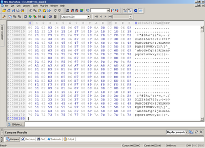

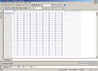

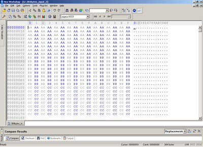

OK, made some very small progress:
1. the "+/-8" drift from the original value from my previous post is solved - my mistake - I made mistake in 1st layer encryption of the "fake" block2 that I was feeding to Roland software. So, the "byte shuffling" Roland are using for 2nd layer encryption doesn't change the value of the input data
2. I generated several small "fake" block2 - with size 256 bytes, 384bytes, 512bytes. So, now the math problem to be solved can be redefined: Find function that on the given input generates the given output. And write it in program language of your choice. the attached files names indicate what input what output should generate.
256bytes input - no change
384, etc bytes input - see the picture and for more see the files in attached "func_input_output.zip"

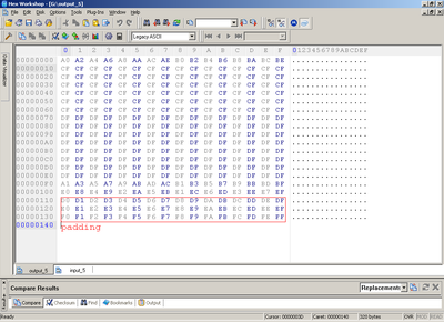

I am over my head with the 2nd layer of encryption, i.e. the byte shuffling they are doing.
Please, check the attachment, to see the output of special input matrix I made. It has to do something with odd and even index of the first 2 line and moving them at the end, at least for first 16x16 bytes, but last 16 bytes are scrambled very hard. Also, I believe it's kind of recursive in nature, because "bigger outside" data (first 16x16 bytes) are less scrambled than "smaller inside" one (last 16 bytes).
Anyone recognizes the algo or has any ideas?!

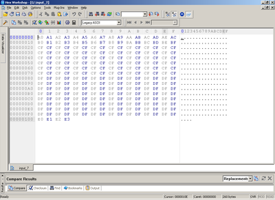

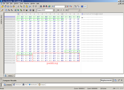

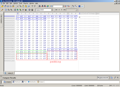

A little closer... see the attached input / output pairs... starting to see a logic... it's like it's divided in 8x8 (64 bytes) matrix, then the remainder (8 in first case, 4 in the second case) is used as number of byte (with odd indexes) to get and put at the back.
Come guys, any genius that can write the algo?

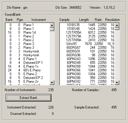

SC55 Sound bank of VSC 2.x has "226 Tones + 9 Drumsets". That coincides exactly with what Microsoft GM.DLS file has - i am attaching picture to show that.
It makes perfect sense, because as you probably know MS licensed the sounds from Roland, but at the end made soft-synth lacking effects like reverb and chorus, making it sound bad compared to other soft-synth.
That's very good clue for when reverse-engineer the whole format of SC55 VSC 2.x Sound Bank - there has to be 1:1 map for "tones", "drumsets" and even for "sound samples" to Microsoft GM.DLS and that last one has very well documented format, in fact whole 77 pages of so called "Downloadable Sounds Format, Version 1.1b" anb available as PDF.
So far so good and that's why as a fast test I made small tool to just extract available "tone name" from SC55 VSC 2.x Sound Bank descrypted with my "vscdec" tool (note here that removing the 1st layer encryption, which we know how to do, is enough to get the names of the available tones), but another surprise:
I am able to find only 217 tones (216 on my picture as I count from 0) - see the attached picture. That's another unexpected thing - maybe I missed something obvious - anyway as next step I will need to compare my list and the list I got from MS GM.DLS to see which 9 "tones" I am missing and why, i.e. where they are to be found in SC55 VSC 2.x Sound Bank.
