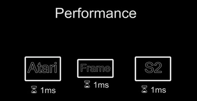

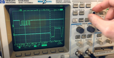

Reply 133 of 307, by dreamblaster
About making sense on MSX...
if it has not been done before, it sure makes a nice retro challenge, to show off on the platform :
for example have a look at this : Amstrad CPC with X2GS : https://youtu.be/zATfSDlGLWw (audio starts at 2:11)
platforms that are 'born' with midi, of course, can make better use, also in games
like on atari ST : https://youtu.be/2n-MxoTx9K0
he also measured the latency...
