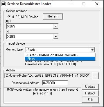

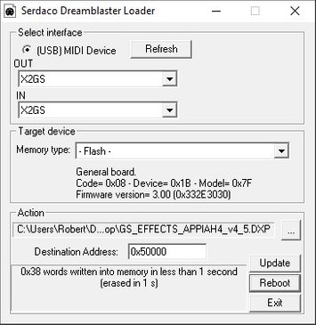

OK I have my X2GS and since I don't know what I'm doing, I flashed it to both 0x5000 and 0x7000. Hopefully that doesn't "hurt" anything. I don't really need the original ROM's since the APPIAH 4.5 sounds so good in the samples above.
Is that all that is needed to activate it from now on? Or do I need to run a .MID file before I use it for games?

OK I have my X2GS and since I don't know what I'm doing, I flashed it to both 0x5000 and 0x7000. Hopefully that doesn't "hurt" […]
for using the GS bank, that's all there is to do, the x2gs boots by default into the GS bank, reading the preset your flashed.
if you want to use the user bank instead, you can play a USERBANK.MID midi file from https://serdaco.com/downloads/X2/X2GS_Documen … on/BANKMIDI.zip
to switch to this bank
