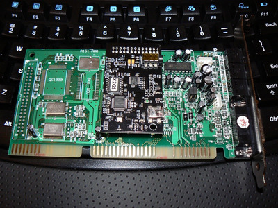

Another happy customer here - the X2GS sounds really gorgeous. I love the deep bass and atmospheric reverb.
335.62 KiB
2351 views
Reply 81 of 307, by cde
badmojo wrote on 2021-07-12, 11:49:
Having also received my X2GS, I have to said it is excellent and a wonderful product. In fact I'm going to sell my regular X2 (I guess at a discount) since with the WP32 McCake plus the X2GS I have pretty much everything I need: WP32 in MT-32 mode for early DOS games, and X2GS for later games.
I'm wondering btw, since the X2 and X2GS designs are very similar, if the current X2 stock at www.serdashop.com could be converted to X2GS (I suppose through flashing the SPI flash chip?) In this way even if the X2GS stock runs out, it could be restocked with converted X2.

Reply 83 of 307, by badmojo
I used the provided software to update the config of my X2GS and it worked well - I dialed down the amp on the GS bank and reversed the stereo. I've also tried switching to the user bank via the .mid files available on the Serdashop website and that worked OK too - I'm using dosmid.exe. I notice though that when I switch back to the Roland patchset it doesn't sound right - no reverb and it's quieter.
Is that expected? It's like the equalizer settings get messed up by the switching - do I also need to do a GS reset or something? If I reboot the PC it's back to sounding freaking amazing.
Reply 84 of 307, by cde
badmojo wrote on 2021-07-25, 10:30:
I'm just wondering why you need to reverse the stereo, it is because your sound card has the left and right reversed for the wavetable header?
Reply 85 of 307, by badmojo
cde wrote on 2021-07-25, 10:48:
Yeah I use a YMF719 based Labway and they have reversed stereo on the wavetable header - an easy mod exists to fix it but not as easy as this option.
