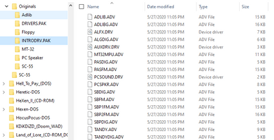

Here are the drivers from HOF CD (I think 😀 ).
47.64 KiB
675 views
I had a look at DMKIT 150 and can see similar, say SBFM* drivers, but not SBDIG I see here, which I imagine is used for speech and digitized sound in the game.

3. Hand of Fate CD did not work in FreeDOS for me with the settings I had, so I spent some time on this and figured out it did not like NOEMS option in my configuration.
Moreover, it turned out the game and the introduction used different sound code and different set of drivers, so I have patched INTRODRV.PAK with SB*.ADV files from DRIVERS.PAK and now longer have any sound cut off-s in the introduction with just DSDMA driver of my PCI Yamaha card. By the way, for patching I used WestPak2 in Windows, which is very easy to use as it has "Replace file" option. I then simply mastered an ISO with ImgBurn.
