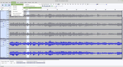

Awesome, thanks for the details, you are clearly on top of the workflow. The full answer is beyond my pay grade, but I spent a few minutes exploring some differences in your recordings. I focused upon your 55-121, 55-Mk2, and 55-ST recordings, comparing the first 30 seconds. I found that the marked differences most audible to me, were mainly in the horn section. (yes yes British comedy fans, I hear you)
251.12 KiB
2413 views
Image: looping and Solo'ing tiny sections, to isolate sound differences between tracks
My dumb assumption is that these are merely the differences to be expected due minor hardware differences, on top of that era's MIDI standards flux. For example some devices are GS, some aren't. Some MIDI files contain GS instruments, maybe even just for the occasional note here or there. Some don't. Even specific issues like CTF (a minor vagary between different revisions of SC-55) have been the basis of many a detailed discussion on Vogons. Merely highlighting the real world differences between "compatible" synths, once you dig down into the details. But I am not expert enough to say for sure.
