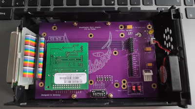

Hello folks!
To make wavetable cards swappable, you convert a removable hard drive caddy with this board, to take a wavetable card. Then you hook it up with an IDE cable to the wavetable header on soundcard. Then you can pull the caddy out with the wavetable board in, and swap it over for another one, without opening your case, and possibly having to remove your soundcard also to do it, if access is tight.
An IDE cable is simply converted as a connection cable and my board is installed.
In addition, you can easily supply the wavetable card with power.,
Simply move the jumpers. I have ordered the first PCB´s and report here on further progress.
best regards
Paddy

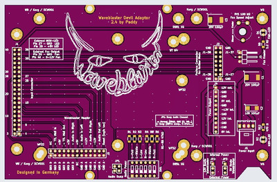

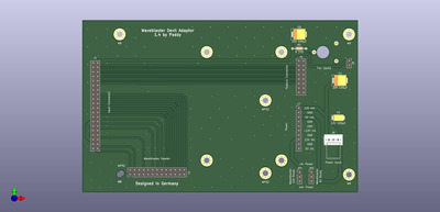

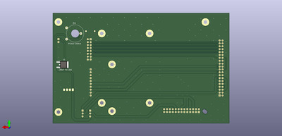

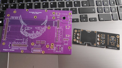

Reply 1 of 26, by Ulfenknulfen
Good News, everybody.
Version 1.4 is finished. It has a build in fan power regulator for the frame fan, and/or the caddy fan.
The PCBs have been ordered and are expecting delivery in the next few weeks.
best reagrds
Paddy

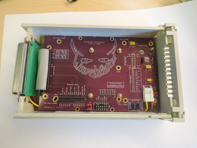

Reply 6 of 26, by Ulfenknulfen
Hi @ all 😀
I´ve tested the first Editions of 'Waveblaster Devil Adaptor' and they are working well 😀
best regards
Paddy

Reply 7 of 26, by Pierre32
Dude, this is a really cool idea, and well executed!
I like having these mobile racks in a build. I guess you could even do a ghetto version of this by simply extending the cable into the drive bay, and having your WT board sitting in there loose. But I like all the functionality you've designed into that board.

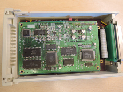

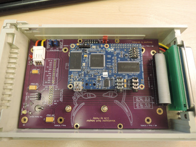

Reply 19 of 26, by dreamblaster
Thanks Paddy for this great solution !!
I will add it in my test pc setup 😀
See it here with different cards installed
- X16L prototype
- XR385 - large card but it fits perfectly
also like the L/R stereo swap option
