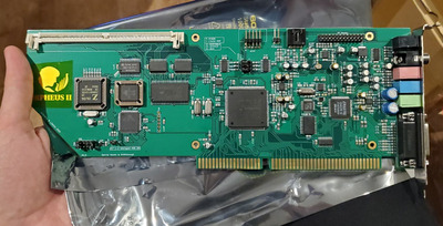

Reply 272 of 301, by Kahenraz
I got my Orpheus II! It arrived packaged perfectly in an anti-static bag with thick foam and a sturdy box. There were also some surprise stickers!

Reply 273 of 301, by igna78
Kahenraz wrote on 2023-04-04, 00:58:
I’m happy for you BUT..this is the discussion about MK8330..you have make a mistake 😂😂😂
If do you want make a new and friendly mistake, NOW send me this magnific Orpheus II sound card 🤣🤣🤣
It’s a joke 😉
Have you a nice day 🤗
