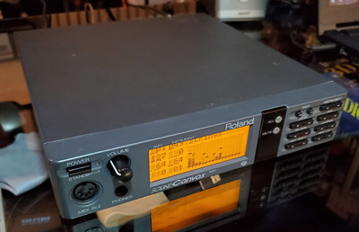

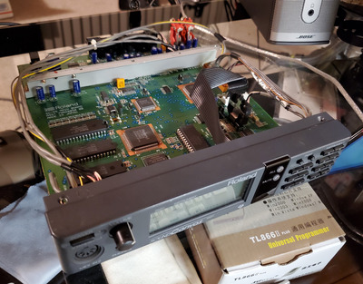

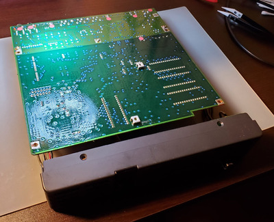

Reply 1 of 9, by Kahenraz

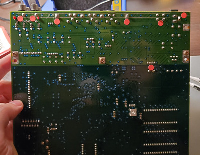

Photos of the unit disassembled for testing, with problem stickers having been placed to help locate issues for repair after inspection.

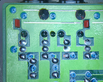

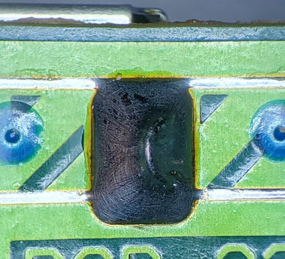

Reply 2 of 9, by Kahenraz

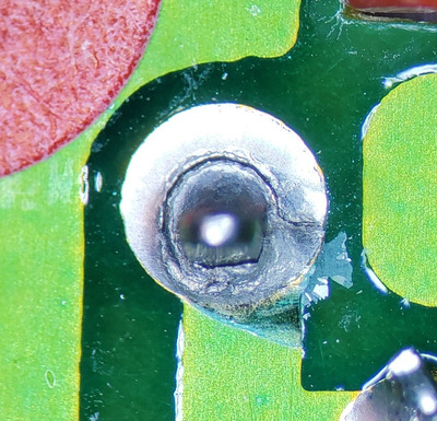

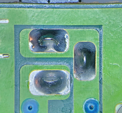

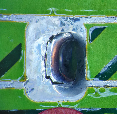

Lots of cracked solder joints and some that are suspect; all of them will get new solder. Taking the case apart like this is an event, so it's better to repair or refurbish more joints now, so as to avoid further problems in the future.
There are more joints that I repaired in the photos here, but these are otherwise the most interesting to look at.

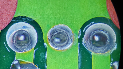

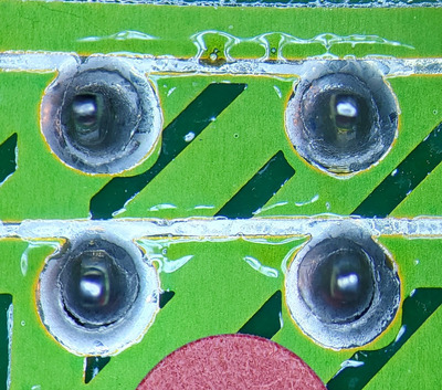

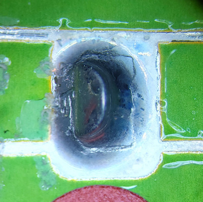

Reply 3 of 9, by Kahenraz

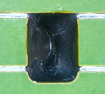

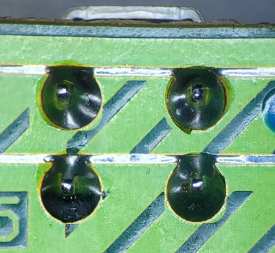

Photos of solder joints after repair.

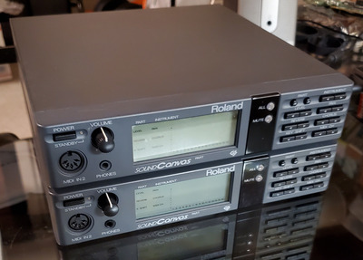

Here is a photo of the two Roland SC-55s stacked on top of each other.
I noticed that the volume nob doesn't have any of that smooth resistance feeling that all of my other Roland synthesisers do. I don't know if this is from wear, a defect, or whether a different part was used during manufacture. It works fine otherwise, but isn't as satisfying to turn.
