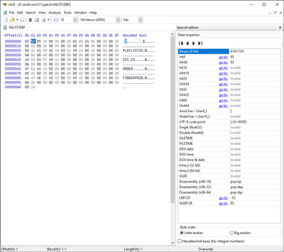

Reply 124 of 149, by GL1zdA
If someone wants to use the MCS MusicRack, that was available from Adlib, it's Y2K incompatible. After launching, it will hang at the splash screen. You have to look inside MediaRacks directory for 2 files: INLIST.DBF and PLAYLIST.DBF and edit the second byte, it's the year, and it should be no greater than 99 (it's a dBase Y2K timestamp bug). Setting it to 0x5D (93) will let the program start. The same procedure works for the "enhanced" version called MCS Stereo.
    61.14 KiB
    1264 views
    MCS INLIST.DBF file

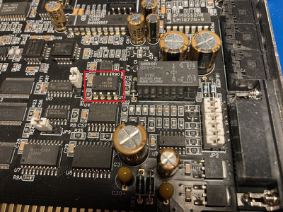

Reply 128 of 149, by GL1zdA
keropi wrote on 2022-11-23, 08:57:
GL1zdA wrote on 2022-11-23, 08:37:
Does the Ad Lib Gold/GoldLib integrate the circuitry that is normally inside the MIDI cable?
nope, it is exactly like the original board
Yes, I know, and it seems the original had everything on board and so does GoldLib. This is the opto-isolator for the MIDI in, that normally sits inside the cable in a Sound Blaster compatible one. Adlib Gold/GoldLib have one on-bard, similar to cards like the Turtle Beach MultiSound Classic/Tahiti/Maui. If the opto-isolator is on-board, then I would assume the other parts are also present, so a passive cable might be enough.
    291.78 KiB
    1084 views
    GoldLib 6N138 opto-isolator
Reply 129 of 149, by Cloudschatze
GL1zdA wrote on 2022-11-23, 09:15:
Correct. Furthermore, this same design element was re-used with the Audiotrix Pro, so the cable intended for that card can also be used with the Ad Lib Gold. (Not that this helps from an availability perspective...)

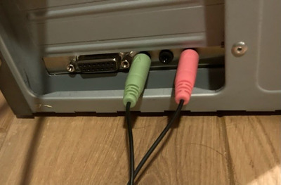

Maybe it's a dumb question, but for the recording test I just have to plug-in a typical mic from a headset into the "last" jack, and it should work? Because it's the one I'm still struggling with.
Reply 138 of 149, by GL1zdA
JimWest wrote on 2022-12-01, 15:39:
The jack is correct. But I don’t think a „modern“ mic will work. I tried several one and only one worked for me. It was this one https://www.ebay.de/itm/133877655249
Okay, I educated myself about mics, and it seems most of these “small”, cheap mics used in headsets and these “stick” multimedia mics from the 90s are electret mics, and they need some power to work (not the 48V phantom power condenser mics need, but still some power), since they have a small amplifier inside. The one from eBay is a dynamic mic and will work without any power.
