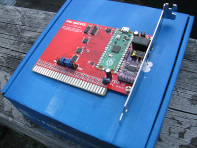

Nice work, looking good, hope all is working well! I see you did the 3d printed bracket too. I don't have 3d printer but I do have a drill press, so I used a steel blank and put holes in it.

Shreddoc wrote on 2023-01-21, 02:29:
Wow, the board looks really nice with a metal bracket with proper holes! Excellent work! 😀
appiah4 wrote on 2023-01-20, 07:36:
Flashing the Raspberry Pico went smoothly, even though mine is (AFAICT) not a genuine part but rather a bootleg. Regardless, card is now ready for testing and hopefully I will have some good news soon as well 😀
Oh wow, that looks so damn good, I wish I had one of those instead!

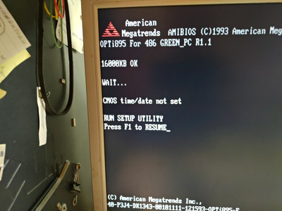

Reply 199 of 1502, by krivulak
So - I tried the new update. Just superior and awesome work, I wouldn't be able to achieve any of this (since I super duper hate programming - that's why I am amazed by anyone who likes it)
But I think some info from testing would be more interesting than my rambling.
Don't take any of this as nagging or something like that. I am doing whatever I can to help you improve the board and beta testing is the best I can do for programmers.
(the delay doesn't change anything where not stated specially)
DOOM I v1.9:
- sound effects are quite scratchy
- takes a long time to load
- sounds a little bit off. Not bad though!
- sound effects stop working after short amount of time, the last one keeps hanging
- when there is a lot going on the mixing gets very choppy. Can be seen in demos
https://youtu.be/XuQL8LKD0SM
DOOM II v1.666:
- same as DOOM I
- sounds more off. For example music in E1M1 uses different instruments than it should. Mainly the drums are incorrect
https://youtu.be/MbXIIDuZUww
BLOOD 1.00:
- on /12 freezes when initializing sound effect in setup
- freezes on start
- on /10 it manages to play but sounds very scratchy and after playing the sound effects the computer freezes
- in game sounds totally garbled and awful. I mean - it totally sounds super duper horror style... 😁
https://youtu.be/tNd8AWE9t14
DUKE3D:
- freezes on start
-in game doesn't sound too bad but after short amount of time the sound effects just stop working but music keeps playing
HOCUS:
- doesn't run at all, freezes on startup
TYRIAN 2000 v1.0:
- loads sountracks very slowly but then it runs nicely, sounding very like original GUS
- on the fade-outs it slows down significantly
https://youtu.be/97pg5l4KwbU
- sound fx scratchy
- computer hangs after couple seconds of the program running but the Arduino keeps going. Quite scary 😁
https://youtu.be/OpTJmfFUApo
ULTRAMID+DOSMID:
- plays quite well actually! The only problems I can hear are those which even the original GUS has (like slowing down a little bit when playing fast MIDI or chopping the sound up a little)
Gravis PLAYMIDI:
- freezes after couple of tones with notes hanging
Sometimes the system bricks SO badly it even manages to corrupt the CMOS. Happened 3 times while testing
The attachment P_20230123_174538.jpg is no longer available
