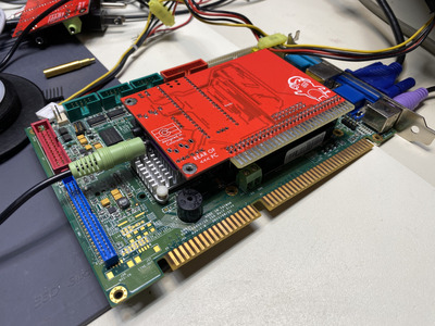

A little follow up on this, it seems like the Vortex86-board doesn't like 8bit PC/104 cards. I got a the PC/104 soundcard by Rasteri made a while ago, and with that connected to the board also the PicoGUS got detected by pgusinit, but previously no luck getting anything to play.
But now with the 1.0.2 version of the software I actually got the PicoGUS to work! The card is detected fine, although I do for some reason have to initialize the other soundcard with Unisound first to get playback to work on the PicoGUS. There still seems to be some issues with DMA, at least Capamod has to be run with the /NDM switch or it gets stuck trying to upload the samples. But at least the few demos I tried run fine now.

I just got a Vortex86DX SBC board to play with... it seems to work pretty well (only failure I saw is SFX in Duke3d stops working after some time). I noticed that the ISA bus timing is very tweakable in the BIOS and it's very easy to get things out of spec so PicoGUS won't work. I can post some recommended settings later.
