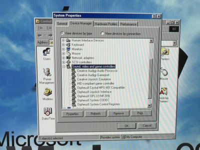

Reply 182 of 659, by KuroHouou
I got the new drivers setup. Great to have OPL3 in windows now 😀 That part is working great. But I now have issues with the MPU401 PCMIDI out. In Windows when I try to play a midi files and send it to my SC-55 it actually is locking up my computer and I sometimes have to do a hard reboot. It seems to send midi to the sc-55 fine from dos in windows which is strange. But a windows midi player has issues. Also I noticed the MPU401 device is missing in the system settings as you can see in the screen shot.. not sure if that's normal. Maybe I'm missing something here..
Maybe need to reinstall the pcmidi drivers again?
Reply 184 of 659, by KuroHouou
Marmes wrote on 2023-01-29, 22:22:
Hello!
You need to install PCMIDI manually. Go to add/remove hardware. Choose it manually. Music Quest then MPU401 compatible. You may need to change Adress and IRQ manually again.
Yep that was it, had to re-add it 😀 Works like a charm now and OPL3 goodness in Windows 98!!! Love this card!!! Still needs another card to play more modern Windows based games though, the Audigy 2ZS works perfect for that.. Glad both cards co-exist so well, its the ultimate setup now!!!

Reply 187 of 659, by keropi
KuroHouou wrote on 2023-01-30, 03:28:
So I have noticed one small issue. When my system boots to Windows 98SE, it also calls Orphus.bat during the boot process. [...]
if you are booting into 98SE you don't need any DOS drivers loading for Orpheus , remove that line that calls orphinit as it could interfere with the windows driver
Also make sure Audigy is not trying to use some resource that CS4237 tries to use (IIRC audigy still contains "sb emulation" functionality in it's driver?)
midi playback issues are also a sign of some resource conflict (port 330 in case pcmidi is jumpered to defaults)
I would suggest making sure in device manager that no two devices try to use the same resources.
if we are talking into pure DOS environment then there is no changes there, just make sure ORPHEUS.INI has usable settings and that's it
🎵 🎧 PCMIDI MPU , OrpheusII , Action Rewind , Megacard , MK8330 and 🎶GoldLib soundcard website
