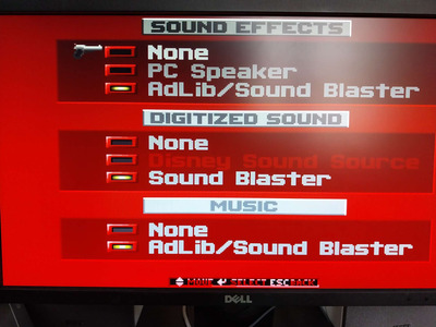

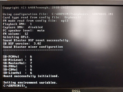

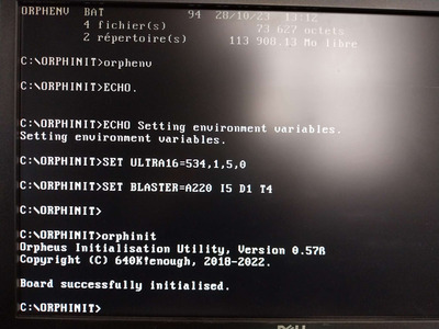

Reply 721 of 884, by Crushdown
keropi wrote on 2023-10-28, 09:14:
Crushdown wrote on 2023-10-28, 09:04:
At this point, would you agree that the problem is bios / mobo related, and not windows related ?
still not sure, try with pure DOS + ORPHINIT some games , ORPHEUS /V will display messages and if there are issues the messages will provide more details than "environment error" one
OK !
You were right indeed, after running orphinit.exe and orphenv.bat in pure DOS mode, I am now able to run wolf3d with perfect SB music and fx !
Now I need to figure out whats going wrong on windows startup ...

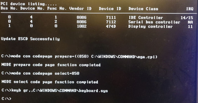

Reply 733 of 884, by P4C800
keropi wrote on 2023-11-19, 06:47:
do you get any of these PnP devices on the BIOS messages when the system boots? similar to this?
And what happens when Crystal part does not work, do you get it listed and it does not work or it disappears from BIOS list as well?

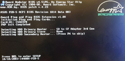

I do get somewhat similar messages: On the post screen I sometimes get one PnP-card detected. However this does not correlate with the Crystal-part working in windows in any way (I can get both the card detected during post but not working in windows as well as not detected during post but working in windows).
85.97 KiB
1336 views
GPL-2.0-or-later
On the "PnP"-screen that follows I only get PCI devices listed and never any ISA devices.

Well, I thought the P2B-S to be good as everything appeared to be working well until I tested the Orpheus. So I do not know how to make sure any of my systems are 100% good. I can only try the following two things: 1. Try more different mobos where everything else appears to be working. 2. Try some other ISA cards if they are working in my P2B-S. I am not sure however if I have any ISA-PnP-cards, I'll take a look if I have any. I do have non-PnP-ones, though.

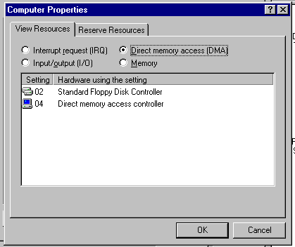

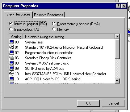

Here are screenshots of my IRQs and DMAs while only the MPU is detected.
5.84 KiB
1336 views
GPL-2.0-or-later
3.96 KiB
1336 views
GPL-2.0-or-later

Reply 739 of 884, by NJRoadfan
I am running the latest stock BIOS for the motherboard, 1011 Beta 005. My board does not have onboard audio. Note that both the Ultrasound PnP and Crystal parts of the board should show up under configured PnP cards on the initial POST screen. In the BIOS, the following was set under the PnP Configuration.
Plug and Play OS Installed: NO
IRQs 3, 5, 7 set to "Legacy ISA"
Onboard serial and parallel ports were disabled to free resources up. Machine has an Adaptec SCSI card, Firewire card, and NIC all grabbing IRQs. I eventually got them to all share an IRQ.
