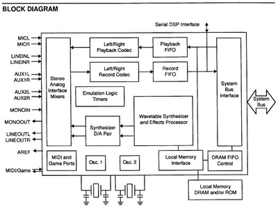

@keropi
Would you consider releasing Orpheus II implementation block diagram for tech nerds here? You have obviously standard CS, AMD IW(attached), Yamaha and HardMPU diagrams from chip/solution manufactures so additional part would be mostly about integration flow. High level block diagram doesn't have enough details so risk someone replicating your work is low I assume.
I would love to get extra warm premium product feeling if your hardware will come with good documentation.
    72.49 KiB
    1920 views
    AMD Am78C201 block diagram

@vutt
I am not sure I follow what you ask or what the point is since there is no weird analog routing on OrpheusII - everything goes through CS4237
if you are wondering how IW is connected to the card then it's output is tied to the "SYNTH/Wavetable" input of CS4237
IW is an output only device on the card - there is no other mixing going on.
also there is no hardmpu on our cards - there is PCMIDI and it works as a separate entity on the PCB with the option to select which MIDI ports you want it to control with it so you can split if needed between PCMIDI and CS4237-MPU to achieve a dual-mpu setup

Yeah I was investigating how IW an CS chip can be integrated? Any digital (serial) output options or only analog....
As for hardmpu indeed my mistake I meant PCMIDI actually.
