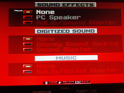

I recently acquired and installed this amazing card, and so far it works well, but I can't figure out :
- how to use soundblaster features (for example wolfenstein 3d does not detect the card)
- how to get ultrasound music in compatible games (I tested rise of the triad and duke nukem 3d, but I am only able to get ultrasound fx, ultrasound music is selectable with no error message, but does nothing; general midi works fine).

Hello,
Thank you very much for your answer,
I am only playing under win98, and both drivers have been installed under win98. I do not use pure DOS mode.
I did not make/use ultrasound directory or .bat nor orphinit files during the process, so it appears I completely missed this step.
I will try to correct this asap, thanks !

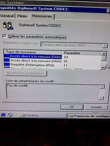

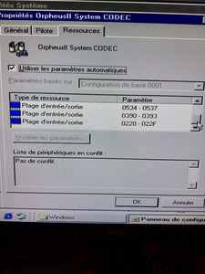

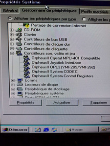

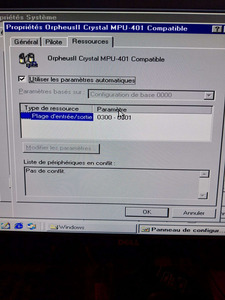

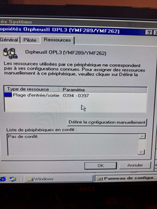

Reply 712 of 897, by Crushdown
Device manager screenshot
Reply 713 of 897, by keropi
drivers seem to be installed just fine
you can select OPL3 or CSFM in midi mapper in control panel or use some player like TMIDI that will allow to select output device via it's menu
I actually have no idea why dos support under windows is not working, on device manager what resources are used for the OPL3 and System Codec ?
what does your autoexec look like? is CWBINIT running on startup?

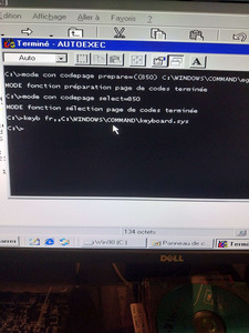

Reply 714 of 897, by Crushdown
keropi wrote on 2023-10-27, 20:33:
drivers seem to be installed just fine you can select OPL3 or CSFM in midi mapper in control panel or use some player like TMIDI […]

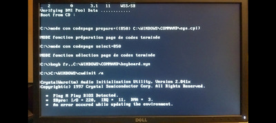

Here are more photo following your questions.
Indeed cwbinit does not seem to appear in the autoexec.
EDIT: I managed to run cwdinit.exe through autoexec, but now I get "an error occured while updating the environnent" message
Reply 715 of 897, by keropi
do this test , add in autoexec this line (assuming c:\windows is the win9x directory) :
c:\windows\cwbinit /a
reboot and test some dos games , do they detect the soundcard now?
edit:
also change manually the OPL3 address to 388 , it should be there not 394
and come to think of it, do some *pure* DOS testing with orphinit to verify that it is actually some windows thing and not some general system issue where resources are not allocated correctly or something
Reply 716 of 897, by Crushdown
keropi wrote on 2023-10-27, 21:17:
do this test , add in autoexec this line (assuming c:\windows is the win9x directory) : c:\windows\cwbinit /a reboot and test s […]
edit:
I added the line + changed the adress. Games still not working under win98, but I get this message on startup, seems we are making progress ! I will try pure DOS testing asap.
Good night

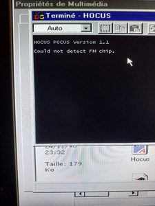

Reply 717 of 897, by Tiido
Is there a "Plug and Play OS" setting in the BIOS ? It may be worth changing it, it looks like the BIOS assigns the card some not so useful values and the Crystal util and windows seem to respect those not so useful values BIOS assigned...
Reply 718 of 897, by keropi
yeah these settings are definitely not good - and the "error updating environment" is not good either
toggle the PnP OS option and definitely enable the "reset configuration data" plus reserve the IRQ/DMA resources as shown in the OrpheusII website
maybe some previous soundcard configuration is saved and bios has the resources locked to it - even though it is not installed
Reply 719 of 897, by Crushdown
keropi wrote on 2023-10-28, 07:24:
Unfortunately I can't find any PnP OS option in the bios, although there is indeed a "reset configuration data" which I activated. I also made sure to reserve the IRQ/DMA resources as shown on the website.
I still can't get rid of the "error updating environment" message though.
At this point, would you agree that the problem is bios / mobo related, and not windows related ?
