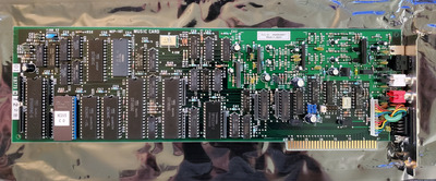

First post, by scg
Hello.

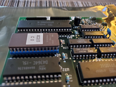

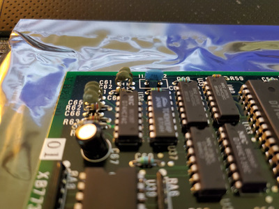

I'm trying to reconstruct a IMFC schematic using photos from the Internet. But not all the details can be seen in public photos. In particular, I was unable to find out the values of some units: capacitors, resistors and ICs.
Maybe someone has this card in the collection and he can see the values that I need? Or take good photos.
At the moment, the circuit is 90% ready and it is very sad that it will not be possible to finish the job due to such smallness.

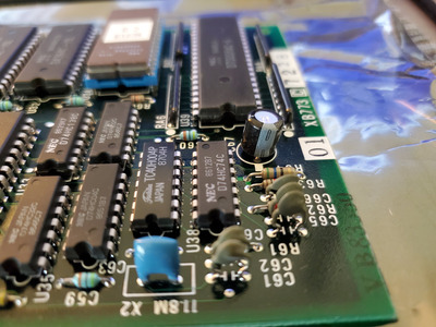

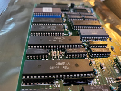

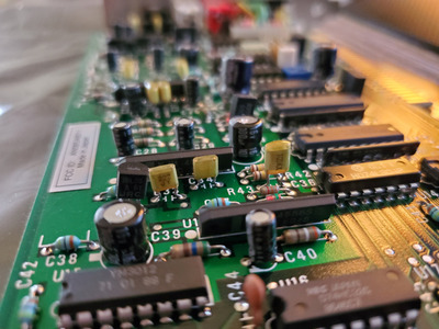

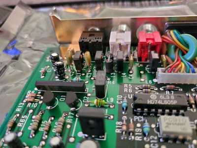

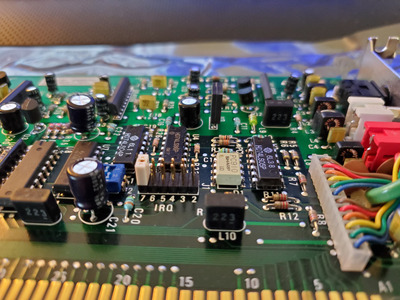

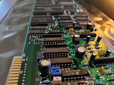

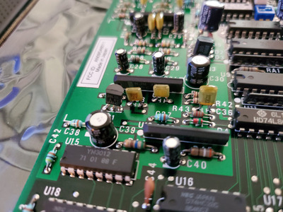

Reply 2 of 46, by Shponglefan
I have one. I can post some high res photos.
See subsequent posts for various close-up photos. If there are any components you need better photos of, let me know and I can take more pics.

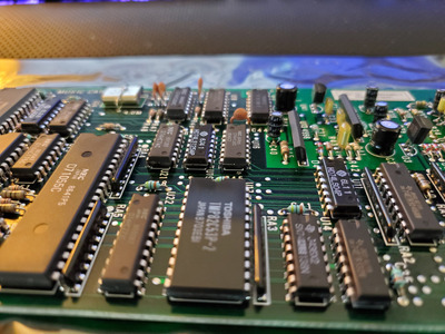

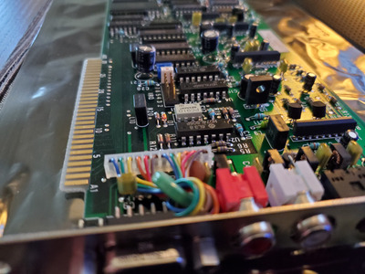

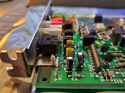

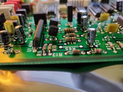

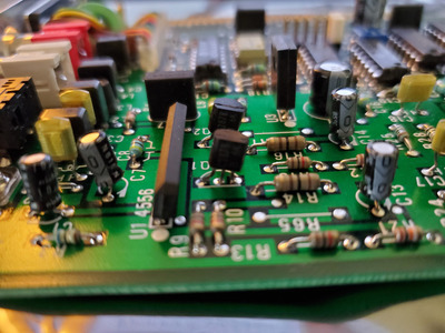

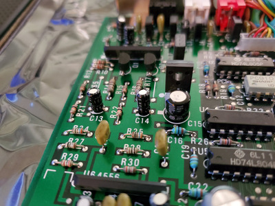

Reply 3 of 46, by Shponglefan
First batch of close-ups
    1.63 MiB
    2059 views

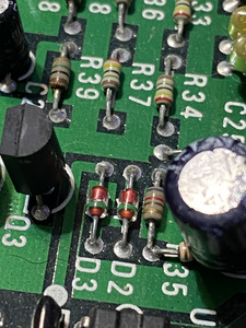

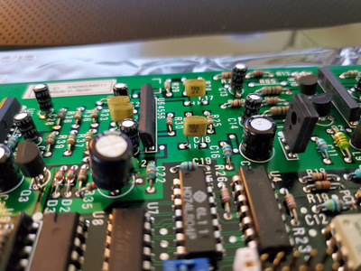

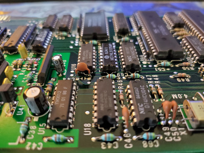

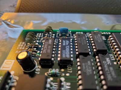

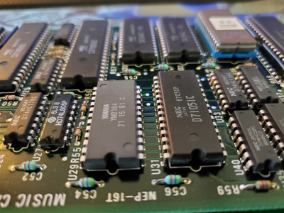

Reply 4 of 46, by Shponglefan
Second batch of close-ups
    1.57 MiB
    2058 views

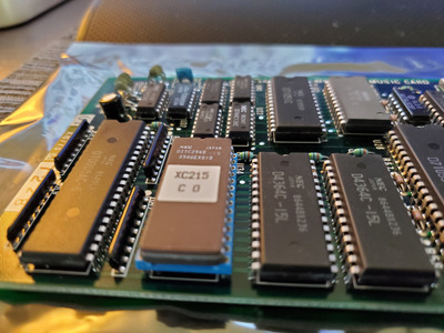

Reply 5 of 46, by Shponglefan
Third batch of close-ups
    1.58 MiB
    2049 views

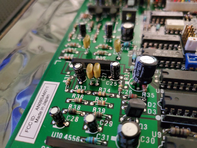

Reply 6 of 46, by Shponglefan
Fourth batch of close-ups.
    1.42 MiB
    2039 views

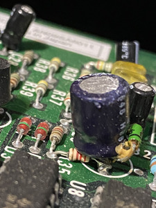

Reply 7 of 46, by Shponglefan
Fifth batch of close-ups

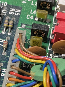

Reply 8 of 46, by scg
Shponglefan wrote on 2022-08-04, 20:26:
Thank you very much! Your photos have been very helpful to me. Most of the issues have been resolved.
There are only a few questions left that could not be seen.
Values of following units:
- Capacitors: C2, C3 and C4, C6
- Capacitor C67
- Resistor R35
- U3 - marking is applied very poorly and is not shown in any photo.
- resistors array: RA1 and RA2
Also interested in marking on a large disk capacitor С5 ((placed near the MIDI connector).
Near it is a similar disk capacitor: interesting its name and value.
There is no need to take pictures. It will be enough if you look at the markings of these parts and write in text.

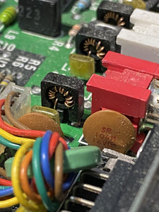

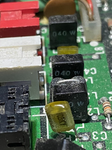

Reply 9 of 46, by libby
scg wrote on 2022-08-05, 19:34:
Thank you very much! Your photos have been very helpful to me. Most of the issues have been resolved. There are only a few quest […]
- Capacitor C67
- Resistor R35
C2, C3:
103KY
303.94 KiB
1867 views
C5, C70:
SR
104M
16V
302.05 KiB
1867 views
C4, C6:
222
JA
329.38 KiB
1867 views
C67:
16V 100uF
RA1, RA2:
RML S8 103J
R35:
308.09 KiB
1867 views
327.42 KiB
1867 views
Reply 12 of 46, by DaveJustDave
scg wrote on 2022-08-24, 19:53:
Thanks for the comprehensive answer. I will try to process this information. I hope that I have no more questions about the components.

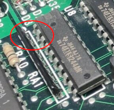

Now, only one thing remains unclear: what is the pin 2 of the resistor matrix RA1 connected to?
Almost completed PCB layout. As soon as I deal with the last issue, I will order the production of a test PCB.

Reply 15 of 46, by libby
scg wrote on 2022-09-04, 07:36:
Pin 2 of RA1 is NC unless this is a three layer board but I don't think it is.
Reply 16 of 46, by scg
libby wrote on 2022-09-05, 19:22:
Pin 2 of RA1 is NC
It turns out that I do not understand the purpose of the wire, which I marked in red in the photo. I assumed that one end of it is connected to pin RA1-2.
62.34 KiB
1531 views
I assume there are four layers: signal-GND-POWER-signal. 😀

Reply 19 of 46, by scg
scg wrote on 2022-09-17, 19:50:
In this photo, it looks like a wire is connected to pin 2 of the RA1.
I'm assuming that pin pin 2 of the RA1 is connected to pin 13 U5. This doesn't make sense, however I can't explain the wire I've marked red in the picture above.
Can anyone check if this is true?
