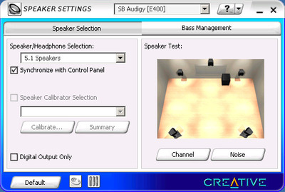

It's easiest to test this on Audigy 2 and Audigy 2 ZS cards, since they support 5.1 (or higher) surround sound out of the box and have an option in their driver settings to completely turn off CMSS. Audigy 1 cards can be used as well, but only if they use ZS drivers. This is because the stock Audigy 1 drivers (from the install CD) don't provide an option to disable CMSS and it's turned on by default. The situation is similar with SBLive cards, which automatically expand stereo sources to surround, without offering an option to disable this behavior.

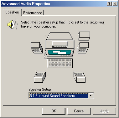

In order to correctly set up your Audigy card for testing this, a few steps must be taken. First, a set of 5.1 speakers (or better) needs to be connected to the card. If the speakers themselves have an option to expand stereo sound, it must be disabled as well. Then, the Audigy's speaker settings must be set to 5.1 (or better) and synchronized with the Windows control panel:
49.78 KiB
2458 views
35.69 KiB
2457 views

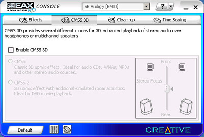

Lastly, CMSS needs to be turned off completely:
45.9 KiB
2458 views
To test if everything is set up correctly, insert a standard Audio CD and play a music track. While the music is playing, check if the sound is coming from your rear speakers. If it is, then something is wrong and stereo sources are being expanded to surround. If the music is not playing from the rear speakers, then it's safe to proceed with game testing. Before testing each game, make sure that the speaker settings are set to 5.1 (or better) since some games automatically switch this to something else. For certain games (e.g. Unreal Tournament and Deus Ex) it's also necessary to enable surround sound from the in-game options menu.
To test for surround support, check if any sound is coming from your rear speakers during gameplay. To differentiate between 4.1 and 5.1 support, check if any sound is coming from the front center speaker.

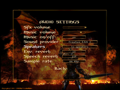

I just noticed that Gothic 2 supports 7.1 surround in its options menu:
150.02 KiB
2311 views
It's one of the few Win9x compatible games that explicitly states this. Neverwinter Nights is another.

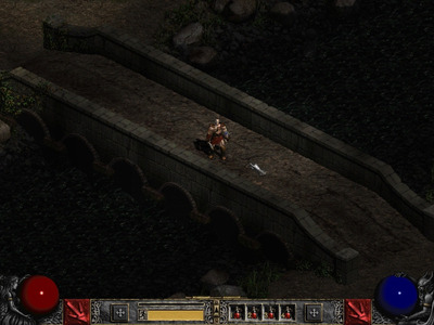

Diablo 2 + LoD expansion + patch 1.10 also delivers full 5.1 surround sound on my setup when 3D sound is set to on and 3D Bias set to medium (default position) in the options menu. Since this is not a first-person game, I'll describe the steps for testing surround sound. When you start a new game, there is a bridge across the river which takes you out of the Rogue Encampment. As you walk across and around that bridge, you will eventually hear the running water sound from the front center and rear speakers, depending on the position of your character.
117.65 KiB
2112 views

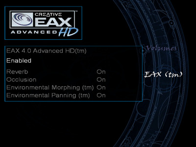

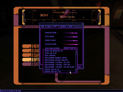

I was testing surround sound in Star Trek: Deep Space 9 - The Fallen. Since this game is based on the Unreal engine, I figured it would support it. Interestingly, the game initially only offers software audio and you have to manually copy over some files in order to get any kind of hardware accelerated sound. Here's what the readme says:
DS9 help file wrote:
Additional 3D Providers
After installation, The Fallen only makes available the recommended base audio drivers. If you wish to use a specialty provider, such as EAX, you need to copy the relevant .m3d file from the /redist/win32/extras folder into the /redist/win32 folder. After copying the relevant .m3d file you can switch to the new provider from the Audio tab within options.
Be warned that changing audio driver from the default can result in slow downs, hangs or audio loss. If you experience audio loss, you may need to restart the game and maybe even restart your computer. Please see the fallen website for additional information.
This does work as advertised, and after copying the files I was able to get the full list of audio providers in the options menu. There's even explicit support for EAX2, something that I haven't seen mentioned before.
135.06 KiB
1894 views
EDIT - I was finally able to get surround sound working using the EAX2 option. Here's what I had to do. I started the game, selected the EAX2 sound provider and then quit to desktop. Then, I edited DS9.ini to set UseSurround=True everywhere that it was set to False. Finally, I went to the Windows control panel changed the speakers back to 5.1 and then also went to the Creative Speaker Settings utility and also set the speakers to 5.1. Why was this necessary? Because the game reverts both speaker settings (independantly) to stereo when it first runs! This is what initially confused me. With all that set, I have confirmed that DS9 does deliver full 5.1 surround sound on my system.
