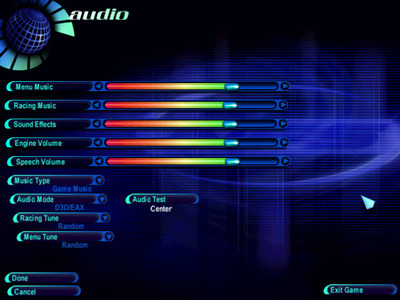

Since I've recently bought the retail version of Need for Speed 4: High Stakes, I can now confirm that it does indeed deliver full 5.1 surround sound on my system when D3D/EAX is selected under Options.
The attachment NFS4_Audio_Test.jpg is no longer available
Furthermore, if you go to Options > Audio > Audio Test it will play a sound through every speaker individually in a 5.1 surround system.
