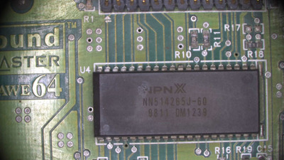

Hi all,

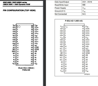

I've got a SB AWE64 with a faulty memory module on it (shorted, it catches fire!). It's labelled NN514265J-50 and I found the datasheet which I attach.
Ebay doesn't have anything (besides a very expensive listing in the US which is even more expensive for me being in the UK).
Can someone recommend a replacement?
Also, what happens if I run the card with no RAM? The sound worked when I tested it but the AWE64 synthetiser was pretty low and distorted, not sure if it was due to the short.
Thank you! 😀

Reply 3 of 23, by tony359
Amazing link thank you so much! It looks like a fun mod! My AWE64 of course has the same pinout setup!
I found the attached, HYB 5118165BSJ-60 would that work in your opinion? I am not sure how a simple 0-ohm resistor move can shift address 0 to 3 though?

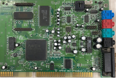

Reply 7 of 23, by Tiido
For ones with IC405A and just CTxxxx written on them it is, only IC405B doesn't run hot.
Reply 8 of 23, by tony359
Here it is 😀
Does it qualify as the "hot" one? 😀
To be honest the card works fine, it's just the RAM missing and I can't figure out why.
Thank you!
    565.38 KiB
    1021 views
My Youtube channel: https://www.youtube.com/@tony359
Reply 9 of 23, by Tiido
Oh, it is the integrated chipset. I am not actually sure what is normal for them, my comment was only for the actual discrete EMU8000. I have few of these cards but I have not tried to see how hot do they get, but I recall them not getting hot.
Reply 10 of 23, by tony359
interesting! It's not so hot, it's a hotspot in the middle to be honest. If you stick your finger on it, it does not feel hot until it does. Weird. Thanks anyways!

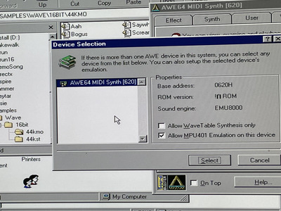

1. The card still refuses to load MIDI banks. The error is the usual "the selected file contains unrecognized format" which I have a feeling it's a false error for "cannot load into memory".
2. I can load WaveFX into memory though. The memory bar gets red and all seems to be working normally. However when I play those samples on "Playback" in the AWE control panel, the sound is as distorted as I had in DIAGNOSE under MSDOS.
3. The ROM version of the card shows some gibberish text under DEVICE
4. If I run DIAGNOSE (under Windows 98 though, I need to re-do my CF for proper MSDOS 6.22) the program detects the 2MB RAM but then it throws an error when testing it. Not sure if this is supposed to be run under Windows though.
Now, I do not know how much of this is my card or Windows. I will test again under proper DOS, meanwhile if someone has any ideas...

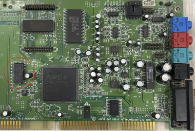

Reply 12 of 23, by Tiido
No, this ROM is the big SOP near the sample memory chip. It shares many signals with the DRAM and I expect you have some short or maybe a break somewhere since the ROM version is garbled and the error message you receive likely has to do with data not being verifyable.
Reply 13 of 23, by tony359
ah-a, we're getting somewhere 😀
Is it the attached?
Is there a way to read it? I'd be curious to see what comes out of it (looking for stuck bits etc).
Assuming it's the chip I highlighted, I buzzed all the lines and they all go to a different part of the main chip compared to the DRAM - and all the pins are connected. I don't have anything shared with the DRAM, nothing I could find anyways.
So... either the ROM is defective or there is something else. Is there a dump of this ROM somewhere?

Reply 14 of 23, by Tiido
Highlighted bit is the effect memory, sample DRAM is the one sitting between the expansion connectors, left of the ROM, the chip you have been trying so hard to get working...
Reply 15 of 23, by tony359
ahhh interesting! Then yes of course, that shares a lot of traces with the sample ram.
Ok, I'll focus my attention there. I assumere there isn't a pinout of that ROM? And is there a way to read it via programmer/software?
thanks!
