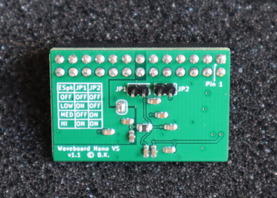

But that was just the beginning. I also made some experiments with a VLSI VS1053 chip, and made another little module called Waveboard Nano VS:
870.1 KiB
498 views
GPL-2.0-or-later
1.3 MiB
498 views
GPL-2.0-or-later
Jumpers on this module are used to configure an EarSpeaker effect - stereo enhancement implemented in VS1053 chip.
